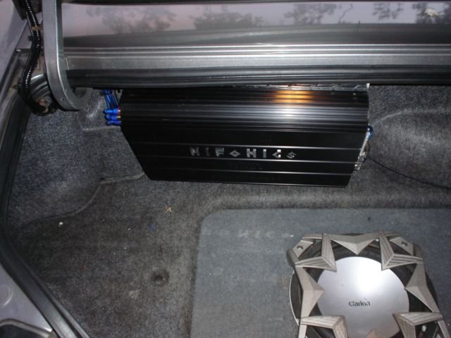

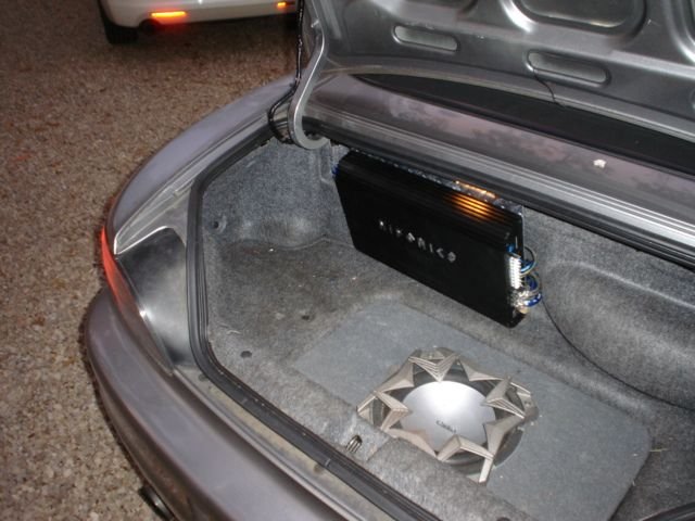

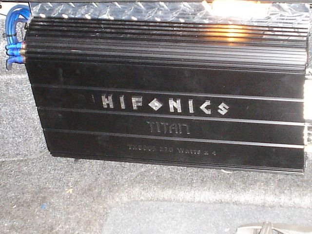

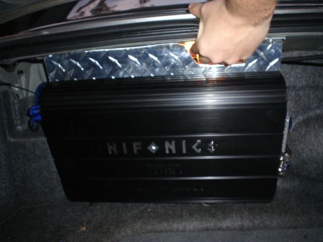

Here are some photos for your viewing pleasure!
This is a shot of the Diamond Plate amp rack. All polished and pretty!
Trunk light is still functional. Polished Diamond plate is a pretty good reflector!
RCA's BARELY clear trunk swing arm. Snug as a bug!
RCA's zip-tied to rear trim panel for trunk arm clearance.
Another shot of diamond plate amp rack, with light covered up.
General angle shot of the install. Spare tire is still functional. Had to trim lower left portion of trim panel so it would fit. Looks great.
