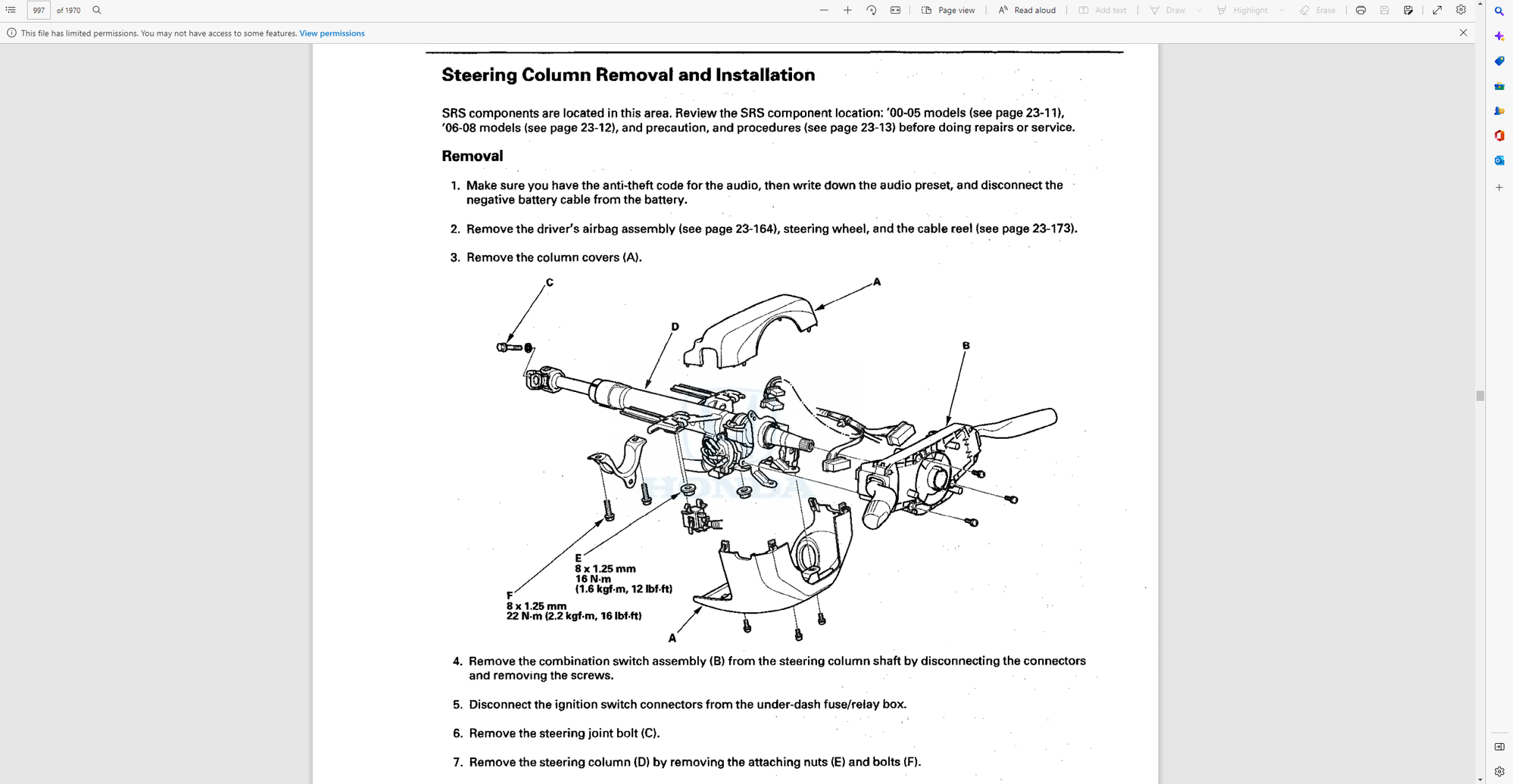

first thing i would try is loosening the 4 bolts that hold the steering tube on in the driver footwell. might be thats it's just been twisted and will spring free once the bolts are loosened.

I'll check it out, thank you.

you should only need to remove the lower cover in step 3 and then you can get acess to the front 2 nuts. rear 2 bolt should be acessible anyway
He did some of that work for me to, broke all my steering column trim off
