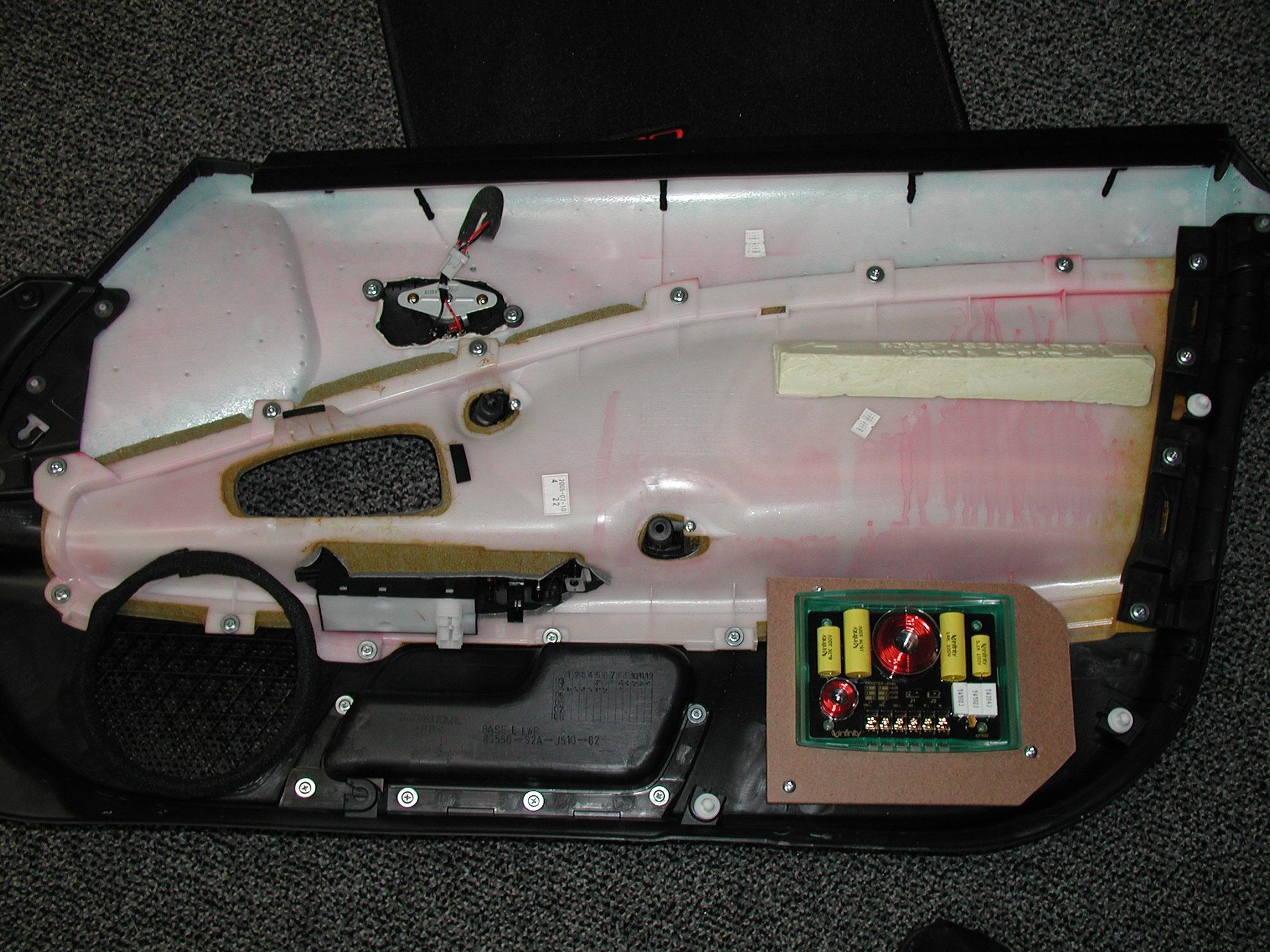

How did you secure the crossovers? I'm going to use the same spot, but I'm not sure what I'll do to keep them secure.

Actually, the crossovers was on the door's panels at that locations. You will need to remove the faked side airbag boxes, then install the crossovers in place of the airbag boxes, using existing screws. Lower left coner of this picture is the exact place for your crossover.

This is a rough fit picture, I trimmed the wood panel much nicer and painted it before the final mounting. As you can see, I removed the factory "box" and mounted it there. Since I Dynamated the whole surface of the door and the crossover is closed, I am not that concerned with water damage (it's not a daily driver either so it doesn't see that much rain).
The tweeter's fit perfectly in the factory locations. They come with a couple of mounting options and I used the factory mounting plate to secure them. I don't think heat will be a problem.
