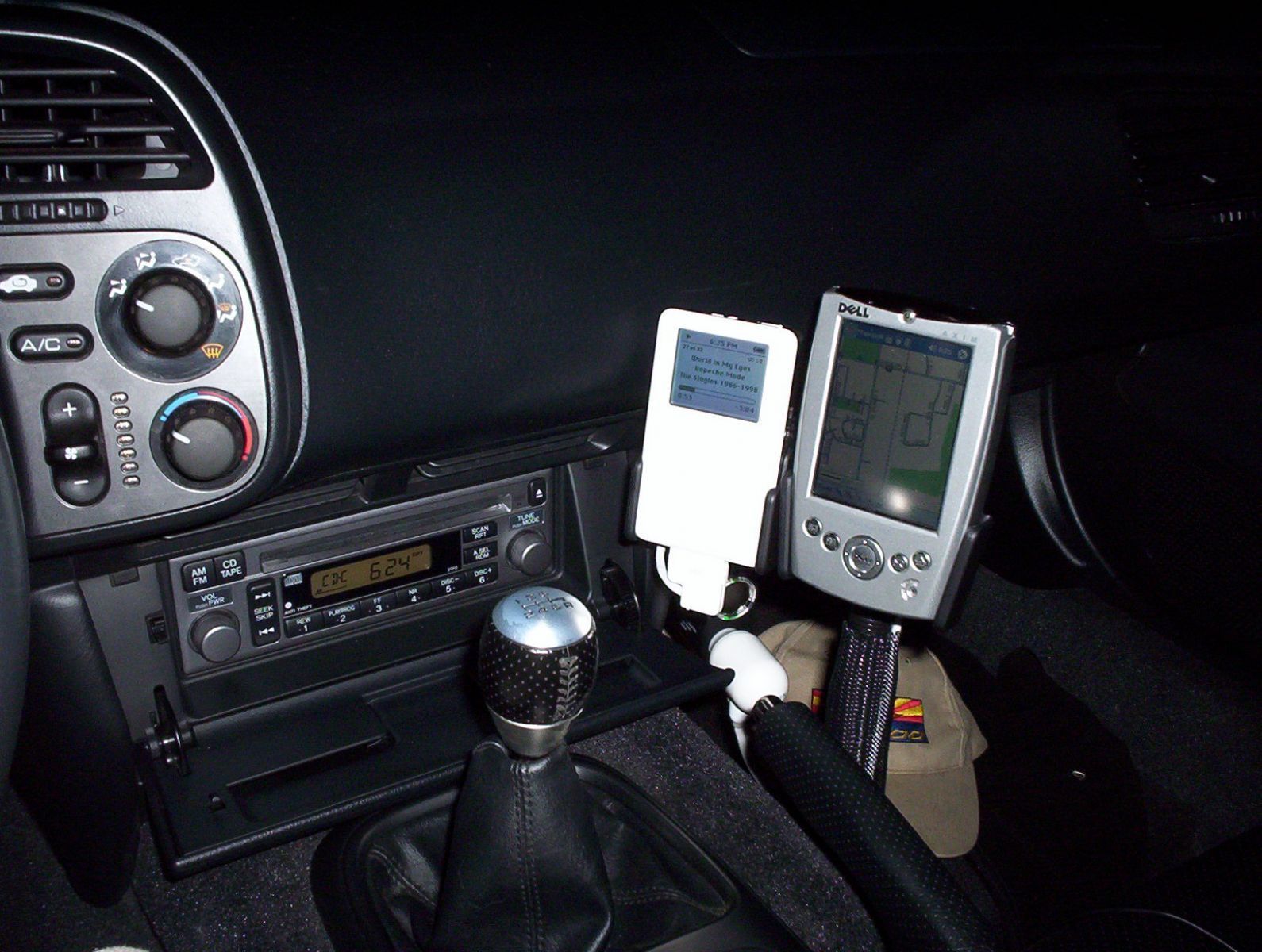

Agree with Robert, the PIE Hon-Aux adaptor is a necessity.
https://www.s2ki.com/forums/showthread.php?...25&pagenumber=1
I installed a power outlet in the front of my car, courtesy of Ron Blanford's instructions and use the Belkin auto kit too. That kit uses a line out feature in the dock connector so you get better sound than the headphone jack.
http://www.blanford.com/AccessoryPowerOutlet/index.html
I have mine mounted next to my Pocket PC GPS system within reach when needed.
You don't need a charger (the Belkin auto kit), but then you either need to buy a ground loop isolator or wire your Hon-Aux to ground it. Once again, the Belkin auto kit (charger) also has a line out feature which makes it easy to connect your ipod.
