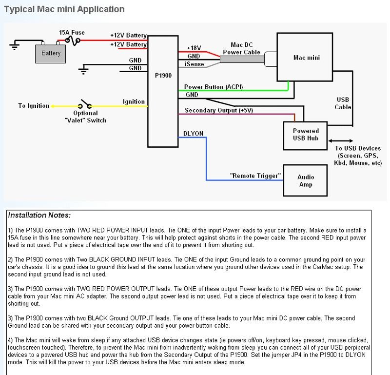

i do have an inverter i used on my last car and i did experience some buzzing with my audio, so i think i'll give it a miss..
the first thing thats going in the car is the gamecube.. and it does have an external power supply, so i guess i can just make a custom direct input..
ignoring the mac mini for now, can the P1900 as far as you know run other 12v devices independently? maybe its worth installing it so its ready for the pc/mac.. its got a startup/shutdown controller so it's definitely the go for the pc!
side qn: what does the ciggy lighter output? and can you splice off that? does anyone know the fuse rating on it?
so.. my plan is..
wire from battery and ignition to boot..
cable usb hub and rcas from boot to dash..
P1900 in boot..

But is the Game Cube 12V? You were wrong about the Mac Mini.
If you follow those links and read those specs you would see that the P1900 has a selectable output and a 12V output so it will be great for a Mac Mini and another 12V device.
There is no upside to tapping off the Power Outlet. It is very thin wire and won't be rated for anything like what you'll need. To repeat, run a dedicated wire from the battery to the converter. Regardless of whether or not the converter has a fuse you need to have a fuse near the battery rated at something above the power requirements. That way if there is a short along the line the fuse near the battery will blow and isolate it. I'd recommend one of these:
