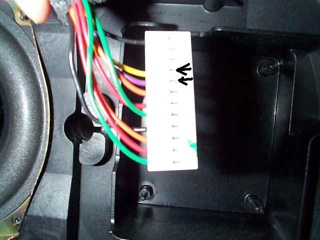

Now, I did some digging and a lot of people were complaining on the rsx forum about how crappy this bose sub it.
It turns out the factory wired the built-in sub amp wrong and it's out of phase/ Acura even put out a tsb on this to changes two wires in the Bose amp and it made the sub 10x louder!!!
Someone was asking about the size of the factory amp. Here are some pics and one of the plug that needs the wire change:

I'm not sure if this fix will hold true to us mounting the subs in our s2000, since I'm not sure if it was all due to the acura wiring, but I think it might.
