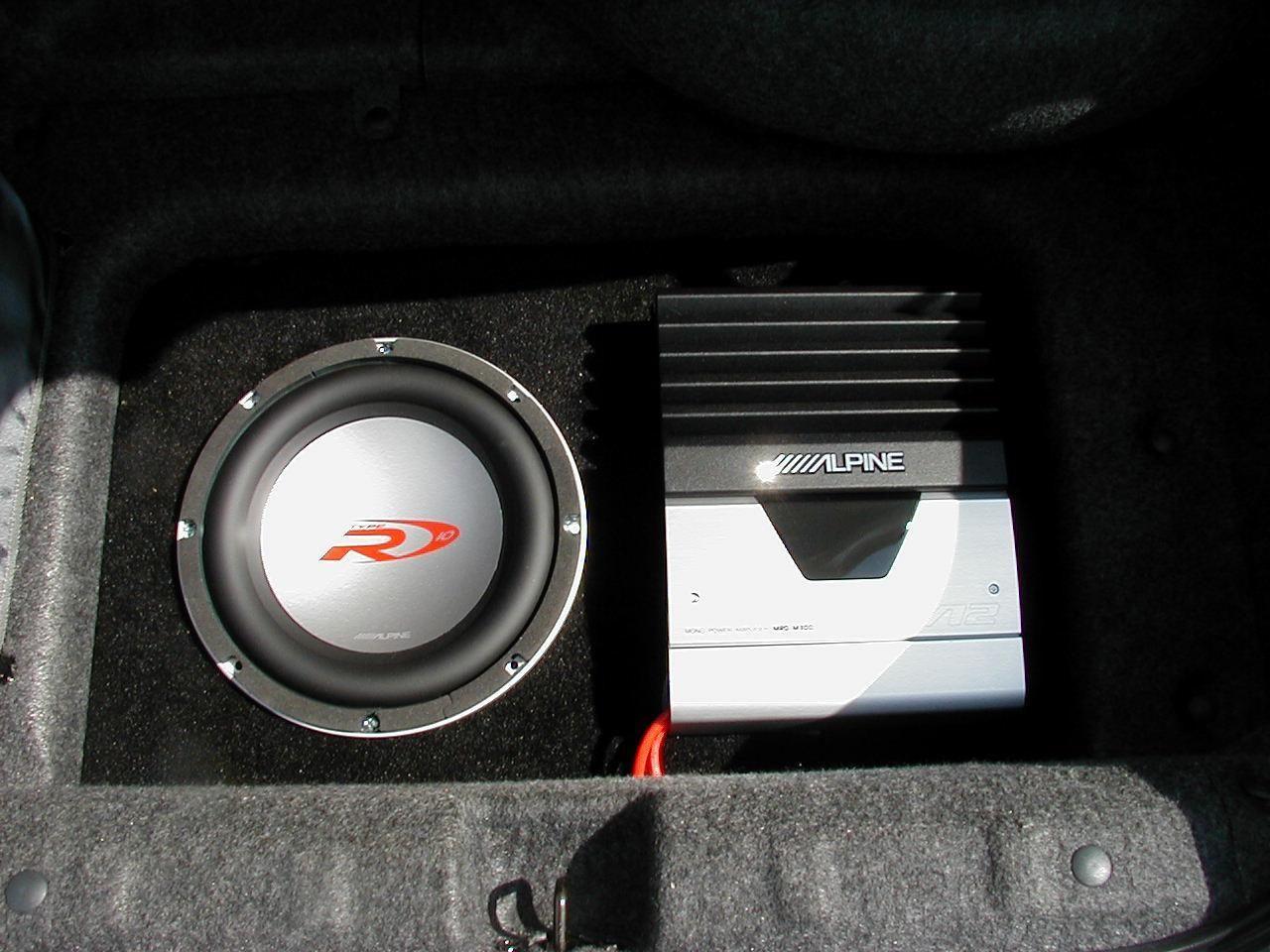

Installed the Alpine 7894 HU last week. This weekend I finished the sub box and got the amp and sub installed. The amp is the Alpine MRD-M300 and the sub is the Alpine SWR-1041D. I turned on the subwoofer output on the HU and used the standard configuration for the amp that was in the instruction manual - NO THUMP!? The sub turns on and is working but at VERY low levels. Need help.
PLEASE! Thanks in advance.
