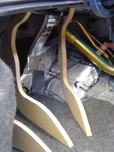

Ok here you go, you need to make a a skeleton backbone like this:
Ok so you need to make the skeleton then once you have the shape you staple or glue the mold fabric in place. Then continue with the build.
