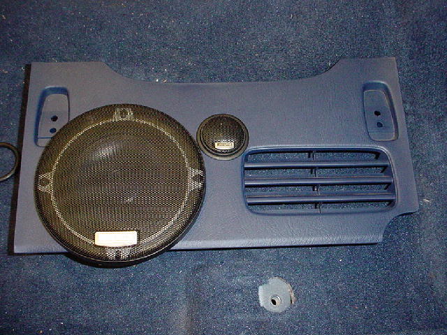

SCZ4 - You say your and OEM man and then in the same sentence you talk about upgrading the speakers and HU. If youre going to do that then do NOT purchase the stock OEM speakers.. they suck. Just put a set in the rear panels behind the seats like this:
The sound difference between not having them and having them is night and day. I have Alpine SPX-133's in the rear panels... its an amazing difference.

Thanks for the information. When I said OEM, I meant OEM look, hence not wanting the S-Pods, but the seats would hide your solution which I like. I assume there is lots of room behind that panel, or did you need to get slimline speakers?

To install those Alpine's required a trimming a little of the metal, not big deal, but they have speakers the use Neo magnets that are far smaller and will fit easier that have come on the market since I installed those Alpine's.

I took a ballpeen hammer and rolled the lips on the bulkhead behind those panels. Made enough room. Its easy once you take the panels off you will see what you have to do. Took me about an hour to do that and cut the holes etc. Getting the holes right is the most difficult part. I used 5.25 infinity reference components there.

Yeah it can be tricky... definitly a measure 3 times cut once type deal. I use a Dremel to grind them out to the right size. Little bit at a time.

I used an airsaw to cut mine as well. Used a template from speaker cardboard to mark small after i eyeballed the alignment. Cut small with the airsaw then lined it up and trimmed where needed to line up the driver with the hole and panel.
