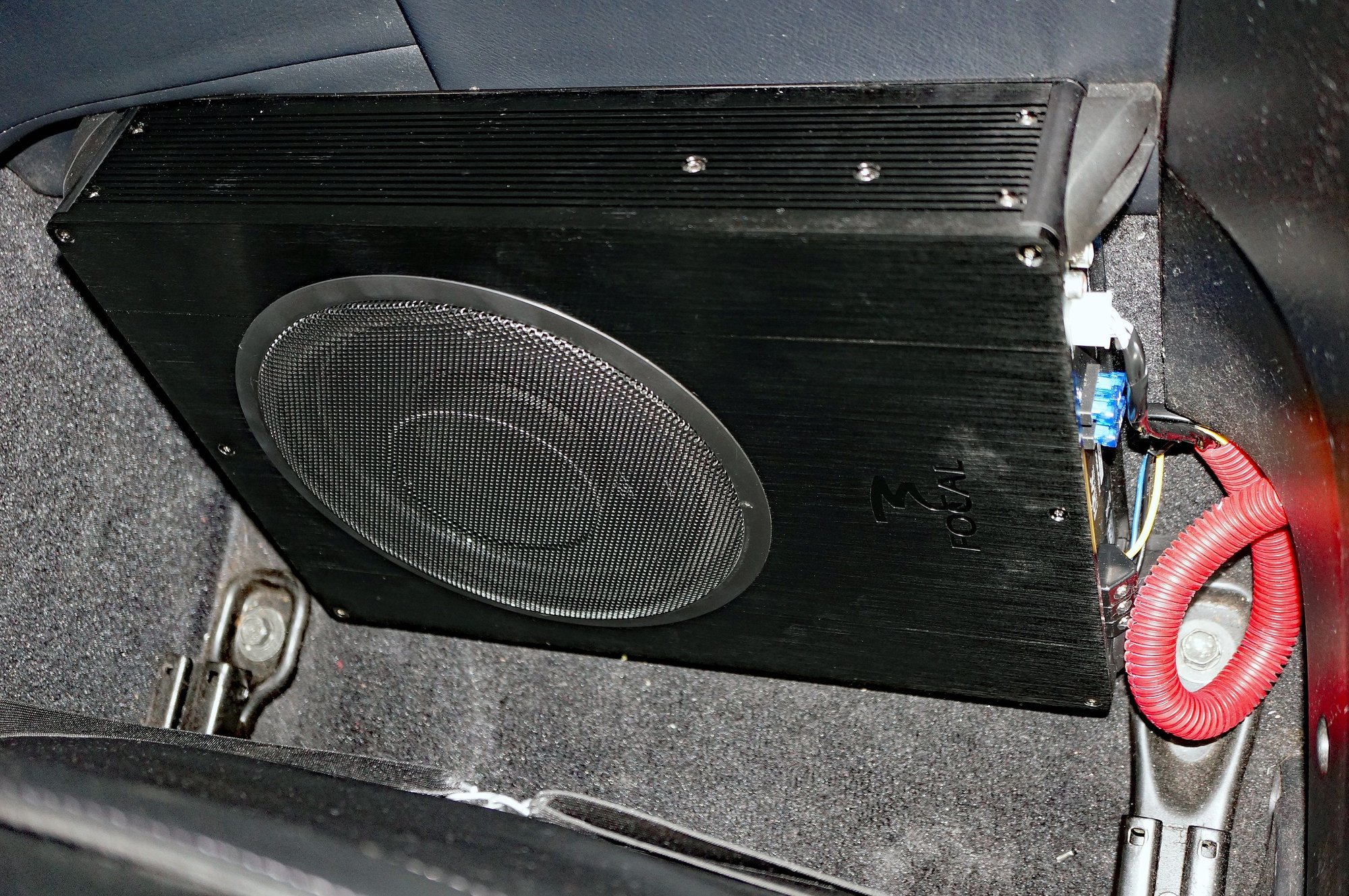

But I was adamant I didn't want to lose any truck or cabin space. Also didn't want to hack anything up. So I mounted an underseat sub in passenger footwell.
I used a Pioneer underseat powered sub. Around $150. So all in well under $500.
Under passenger carpet footwell area is a large white Styrofoam block. About 2 inches thick at its fatest. It tapers off as it rises. Under this is about .75" of soft, black foam rubber. I cut a slot in both of these to fit the powered underseat sub.
The sub sits flush to where the carpet was before, except at the top. As the white styrofoam tapers off near the top of footwell area, the sub is thicker than the foam it replaces. So it bulges carpet slightly. Not really noticeable. But Pioneer has us covered, as just yesterday they released a new, smaller powered footwell sub. Similar specs as what I used, just smaller. It'll fit in this spot with zero intrusion.
This thing is also class D, so no heat issues running in this spot.
No, of course it doesn't hit like a 12" sub in the trunk. If you need that, there is no SUBstitute (see what I did there?)
But if you just want to round out your system and take the load off your door speakers, its ideal.
I solidly mounted it to the floor woth self tapping screws (passenger footwell area is sealed off from the road, so you're not putting a hole that will let in water or lead to rust). So you feel some vibes in the seat and door armrest. Nothing like the hit from a big boy sub, but again, this isn't trying to be that.
This setup has allowed me to crank the volume higher and maintain sound quality. Plus it all sounds fuller with more bass produced.

I'm not a rap guy eirher. Old school rock and blues. Never thought I'd need or want a sub. Only reason I went there was I wanted to really crank it up sometimes, and it would get muddy and lose clarity.
What I did first to see if a sub would help was setup my hu to think it had a sub, then also setup the hpf to filter out the sub frequencies from the door speakers. Aftermarket component door tweeters already have a physical electronic hpf a one of the components.
Then I compared how high I could crank up volume before distortion after vs before, playing the same songs. Significant improvement. Decided right there to add a sub. Meanwhile I left it setup like that, no sub frequencies being produced at all. I liked the sound better that way at high volumes.
I added the sub to fill those missing frequencies back in. Of course, now they they really thump, which rounds out the sound nicely.
