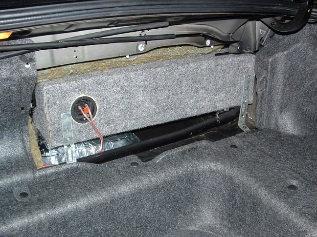

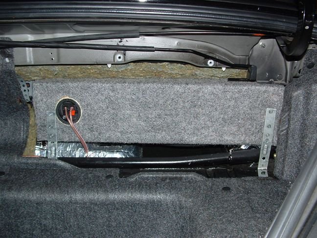

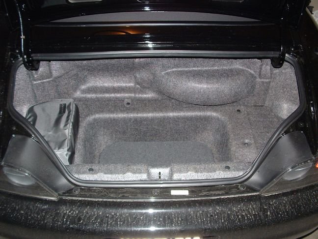

I have the Pioneer 12" sub that you mention above.
It is installed into a sealed custom box that I built with "Tukluc" on the board.......It is installed in the spare tire well as you can see from the pics below.
The sub is downward firing.......making use of the space where the spare tire bolts down for speaker travel.
The enclosure volume measures out close to .76 cubic feet..........Sounds great & it's hidden from view
Pioneer recommends 0.6 - 1.0 cubic feet
We saved the template......this is our 3rd box that we have built...........In the first 2 we used MTX 10"..........the 12" Pioneer hits harder & sounds better / deeper than the 10's
It's powered by a JL Audio 250/1
I'll see if I can find a few more pics of the box by itself / not installed
