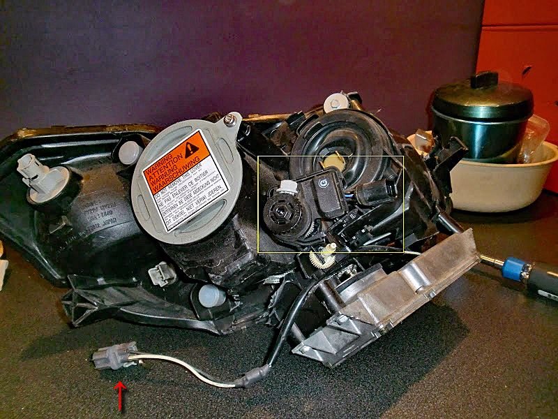

Hey everybody,
So I'm working on my headlights and noticed the whole job is a craigslist special. Somebody down the line before my replaced the turn signal connector with silicon and I'm trying to get a replacement connector to bring the car back to normalcy. The turn signal bulb and socket are the original and in good condition, it's the connector that goes into the socket that is just silicone, and I can't find where to order a new connector so I can keep the oem socket. As a side note somebody also replaced the headlight bulb connector with silicone, which I'm replacing with some connectors I got off amazon so they maintain some semblance of normalcy after I replace the electrical tape with proper heat shrink tubing. Thanks for any replies in advance, I really appreciate it, and stay safe out there everybody.

Which connection are you talking about?
Thanks!

The one in the top left of that picture that's for the turn signal, I need the connector that goes into the wiring harness, currently it only has the two plugs and wires since I cut off the silicone they put before me. Fortunately it still has the socket for the bulb that attaches to the headlight housing.

So you need the connector next to red arrow?
Maybe, check Honda Parts site for parts number? Or call them?

The red arrow looks like its coming off the HID ballast, I need the plug that goes into the turn signal which is in the top left of this picture. The socket that takes the large yellow bulb, I can't find a part number for it, and I can't find any way I can get a hold of one without finding someone who would cut it off another harness for me

Actually I take that back, I looked at the link you sent more closely and it looks like they sell the connector I need. Thanks so much, this is gonna make my life so much easier.
