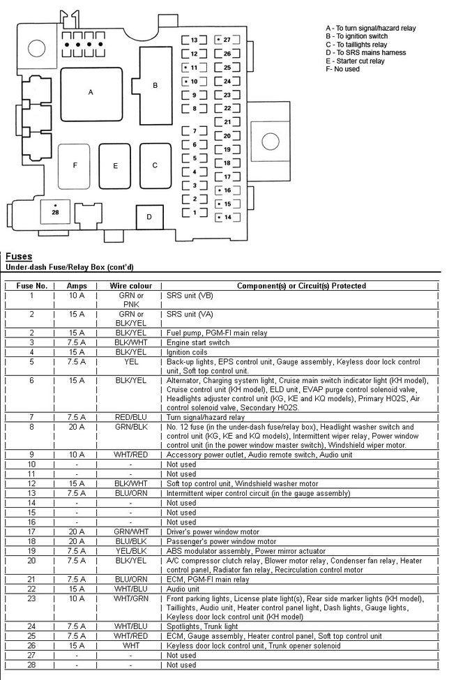

There's a tail light relay which could be bad in the under-dash fuse box, labeled "C" below
Old Sep 12, 2019 | 05:26 AM
Lowlow03s2k's Avatar
Joined: Aug 2019
Posts: 6
Default Yes after searching I found that diagram need to test the relay thanks

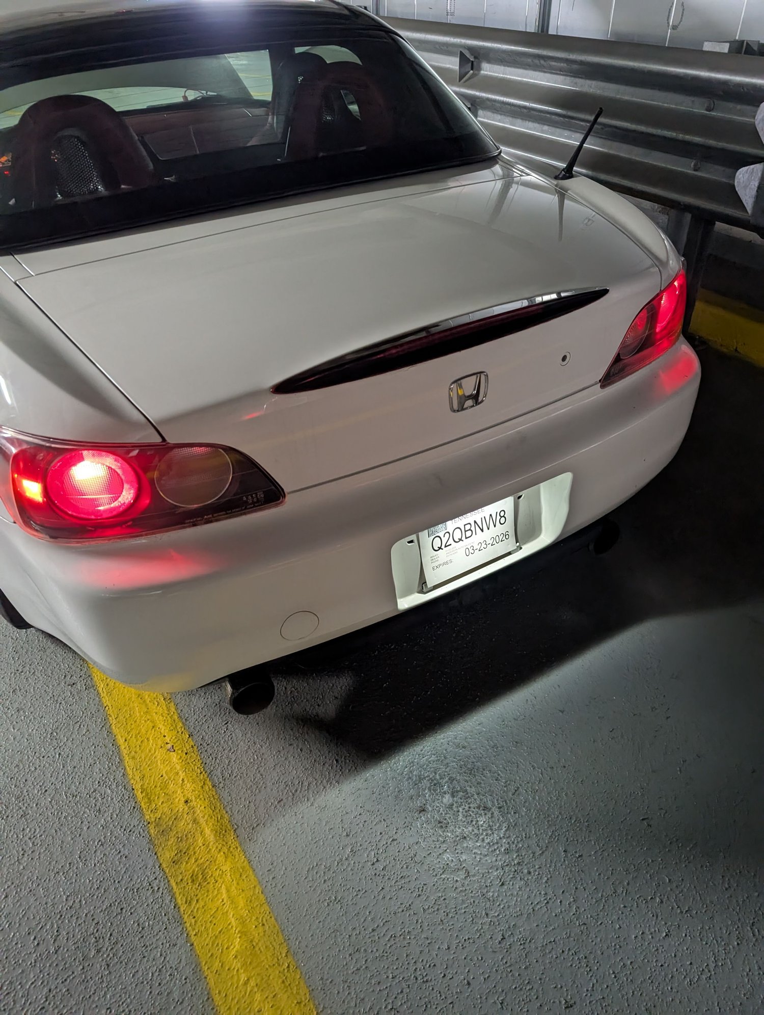

It was the relay, swapped for the one next (e) to it and the running lights are now working. Given that the relay E wasn't in place the car started up without hitting the start engine button just by turning the key.
Thankfully seems like the relay might be the same ones I have for my hardtop subwire harness will confirm when I get home
Attached picture of relay and running rear ligha
Rear running light and plate lights
Relay rear running lights
