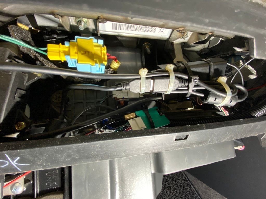

This weekend I removed my Alpine IDA-X305S (along with it's external bluetooth interface module, an Axxess dash control interface + relay that was installed with it, plus a huge early XM radio module) and installed the new Sony DSX-GS80. I installed the Sony with a Modfry DCI plus SCV connection and a new XM radio module.
Even though I originally powered the unit from the factory harness to get things running, I disconnected the power and ground wires and then tapped the 40 amp constant connection at the fuse box to feed it power and made a new ground connection to a bolt located behind the small console cover on the passenger of the radio. I still wanted to ensure the head unit had all of the power it needed even if it was unnecessary / overkill. The gauge of wire feeding the power to the factory harness is pretty thin which was my final deciding factor in doing the extra work which may or may not be necessary. Many thanks to @oth for letting me know I could stay within the interior of the car to get the power I wanted because I did not relish tapping the battery for power and running a wire through the firewall.
Overall, the Sony installation went without a hitch. I was so relieved given I've never installed a head unit it a car before and had to excavate quite a lot of older stuff that worked just fine but its was a spaghetti fest of wires given the external bluetooth module and the old XM radio module all had their own power feeds from the old Axxess head unit harness. I was also relieved that the radio door closed perfectly, so rest-assured this particular head unit is a good fit.
The Sony fit into the dash nicely. To keep the wiring behind it to a minimum and provide easier access to the extra stuff without the need to ever have to remove the head unit, I installed the Modfry DCI, XM radio module, and the Sony's rear USB cable in the cavity behind the passenger lower dashboard cover. In case you're wondering, the Sony USB cable is attached to a USB extension cable that runs to the inside of the rear center console. I didn't want to run the Sony cable to the center console. I wondered if it would be long enough, but that didn't matter since I already had a good cable installed that had connected to the Alpine unit I removed.
At the time I purchased it, the Alpine unit was considered to be a great head unit. It served me well, until I could no longer get more recent iPhones to work with it. But the Sony completely blows it out of the water in every respect - the functionality is excellent, it has more power, and as you can see in the picture you can adjust the color of the illuminated display control and the display itself to be a perfect match with the rest of the dash. I was amazed that I could crank up the volume on the Sony with little to no distortion at the top end of its range. I'd say the only I'm not impressed with thus far is the Sony iPhone app that interfaces with the unit, but maybe I just need to spend more time learning it. I've attached two pics so you can see the unit and where I placed all of the "extra" stuff to ensure the head unit comfortably fit.
I'd highly recommend this mechless head unit as an option worth considering to anyone in the market for something that's about as modern as you can get in a single-din unit without a fancy display screen.
