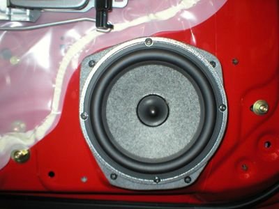

Yes the 165K2P should fit with an adapter ring like this:
The mounting depth on the 165K2P is 2.8" and the Utopia that I have mounted are2.95"
Here is how to make the adapter rings.
