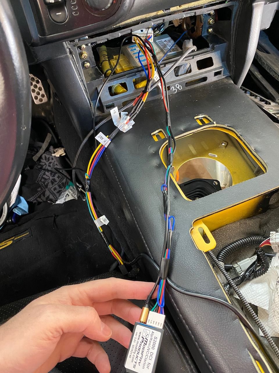

Modifry DCI harness soldered and heat shrink into Stinger radio harness. I un-pinned all of the connections I didn't need. I normally leave these a bit longer because it makes installing and removing the headunit easier.
Harness installed prior to adding wire loom. The DCI will go into the passenger side footwell. This will give me access to adjust the settings if needed. I also have a couple of USB cables and a HDMI cable running that way. You can also see the Toslink cable in the center console and some sound deadening foam. The Toslink cable is the only thing connecting the headunit to the amplifier.

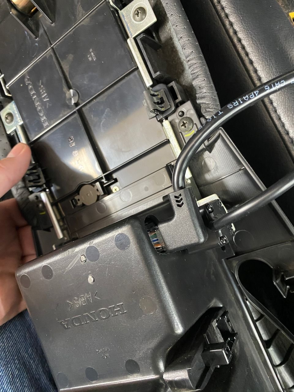

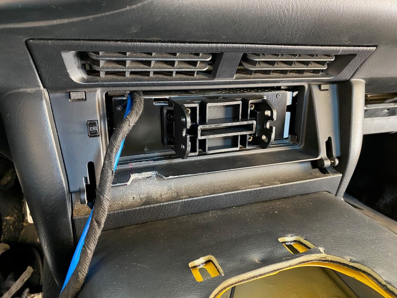

This is the Stinger Elev8 single DIN adapter. The electronic unit fits perfectly into the factory location. The cables you see here are for the display and will be hidden behind it once the center console is back in and the screen is installed.

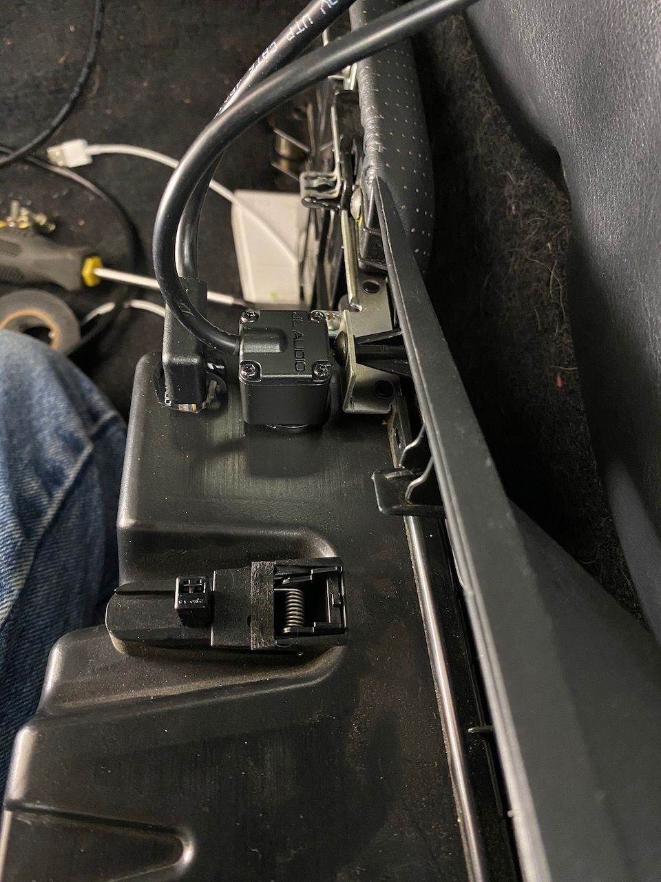

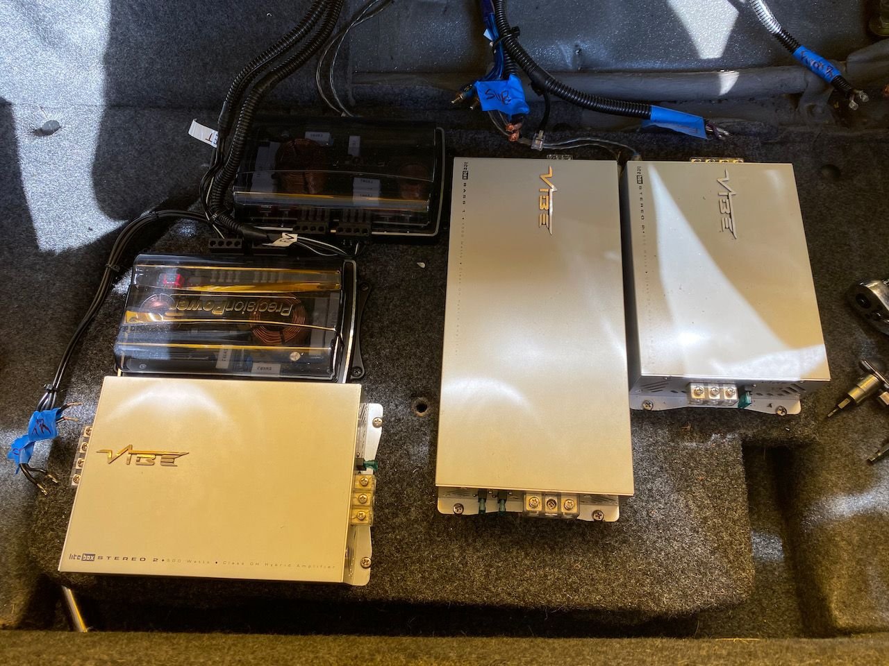

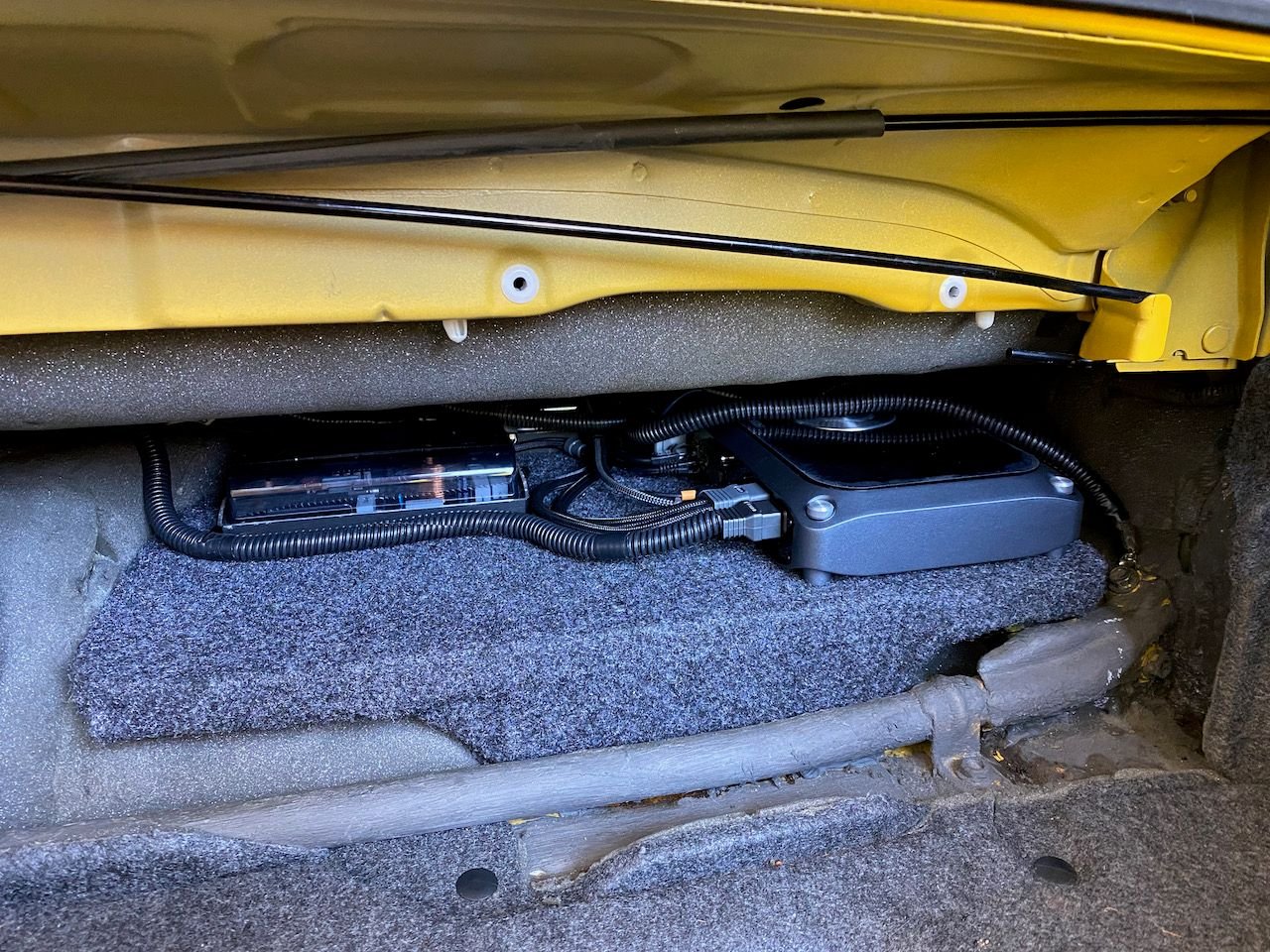

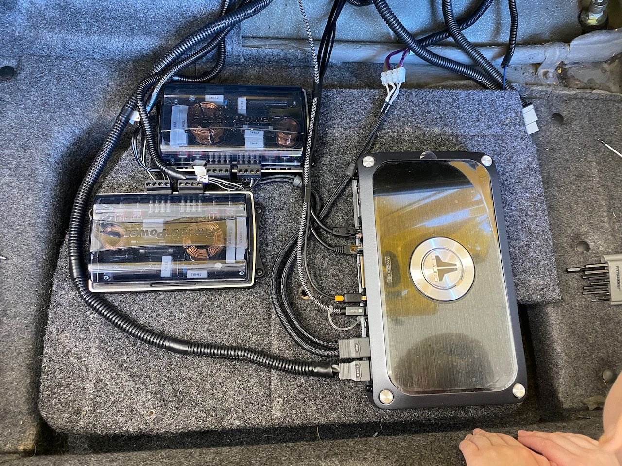

I upgraded from these old Vibe amps to a single JL Audio VX1000/5i. This allowed me to remove all of my RCA cables and replace them with a single all digital Toslink cable. I also removed a bunch of power wiring.
Ground is a bit short because I re-used an existing cable, but it will work.

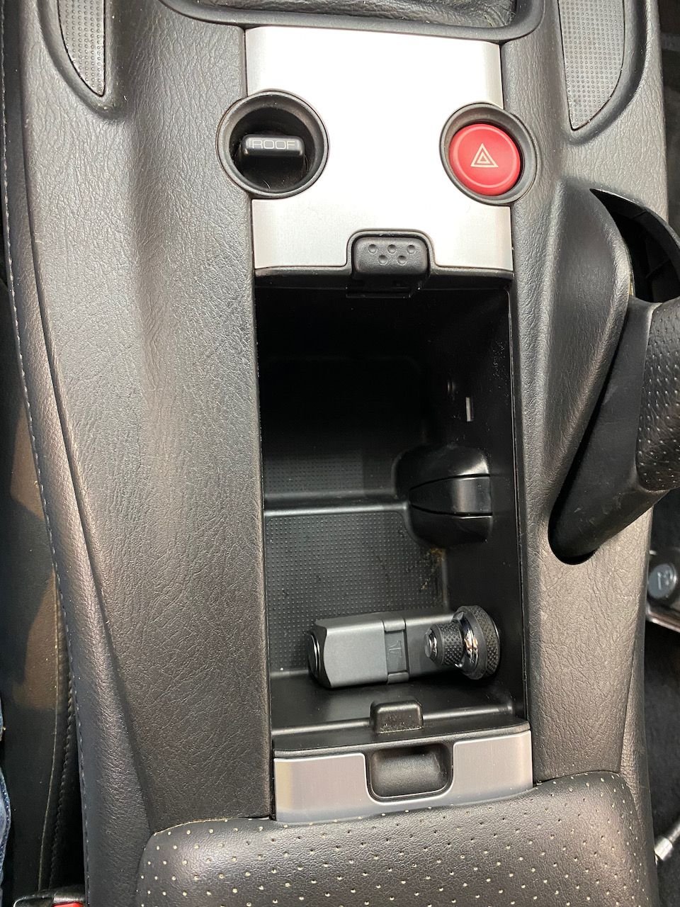

I decided to stick with my original AP2 center console. I drilled a couple of holes to install the JL DRC-205 remote volume control and bluetooth button for amp setup/configuration. These fit really well. I'll post a picture from the other side once I re-install my shifter and get the center console back in.

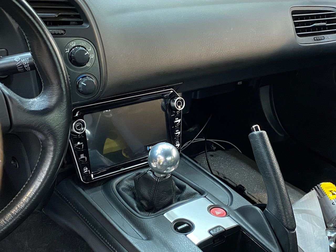

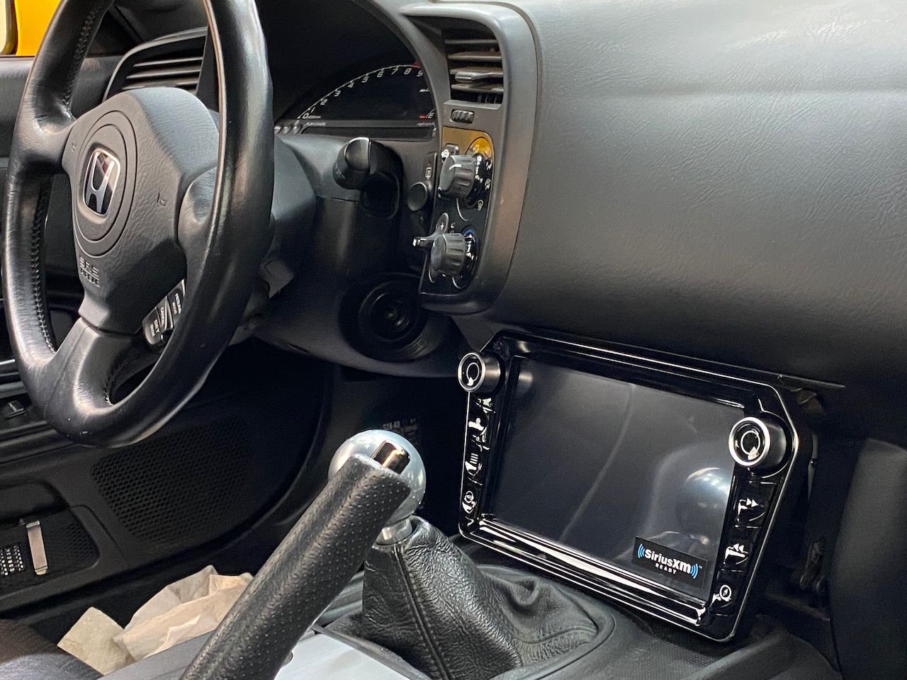

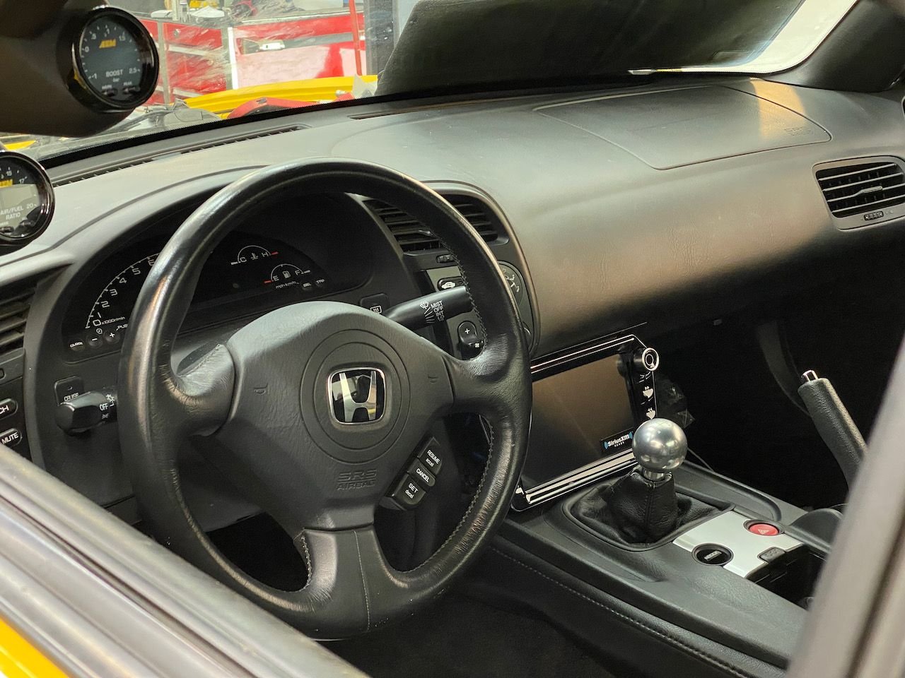

And here it is installed. Screen protector is still on and I still need to lock the screen angle in place, but I'm going to wait until I re-power the car and complete setup/checking of functionality before doing that. When you're in 1st, 3rd, or 5th, there are still an inch or two between your hand and the screen.
If you used an AP1 center console, you could definitely custom-mount this deeper into the car, but I like that this is using 100% factory mounting. The only modifications I had to make were removing the radio door and one cut in the radio surround (shown above) to fit the screen cable connectors. I bought an eBay radio surround for that.
