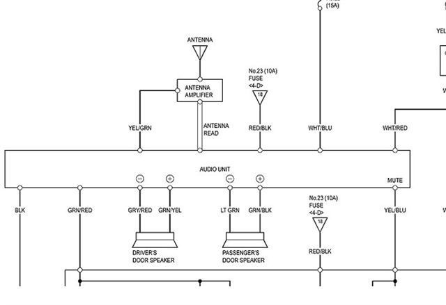

I am replacing my stock front speakers and need to figure out what the wiring schema is. I think I got it for the passenger side (black/green wire is negative, and green is positive), however what is it for the driver's side? It doesnt use the same black stripe? Any help would be much appreciated. I am doing the install right now and this is the only thing holding me up.

Hope this will help you mate.
