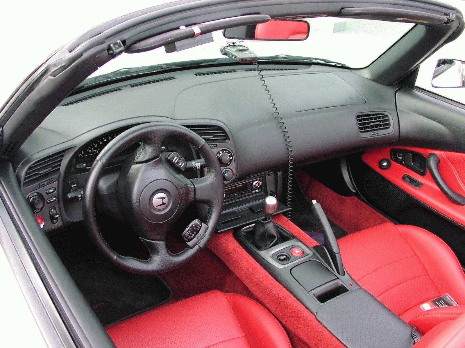

Here's a pic of where I mounted mine just to give you an idea. JL Audio xr componets. The tweeter is mounted above the panel that holds the 6.5. I was unable to use the angled mount because there was no room beneath for a flush install.
I have not sampled various tweeter locations but I can tell you I was very satisfied with the placement. You don't wanna mount the tweeter to high in the door panel because the sound may become some what distorted with the top down.
