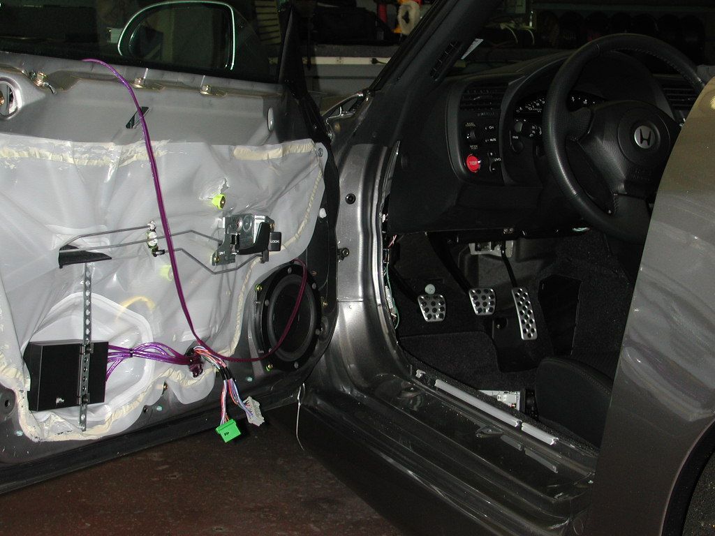

yup... here too ... the little box in the door is where mine reside.
if you use the search, there are a number of threads on this issue that include pics...

I've done it on other cars, but after pulling components out of my Integra when I sold it, I found that all of the screw heads and terminals were rusty and corroded. Remember, car doors aren't watertight. Since then, I prefer to keep the crossovers inside the car.

True, however there are plastic boxes molded right in to the backside of the door panel. All you need to do is cover that box with some watertight material, I used some thick plastic tarp material, and wrapped it with duct tape.

ditto here. i just had the door skins off this past weekend (after a few days of rain. the x-over was dry, the speaker had a small amount of condensation on the magnet boot.
the door should NOT be water tight, there should be a drain hole to allow water and moisture to escape.
