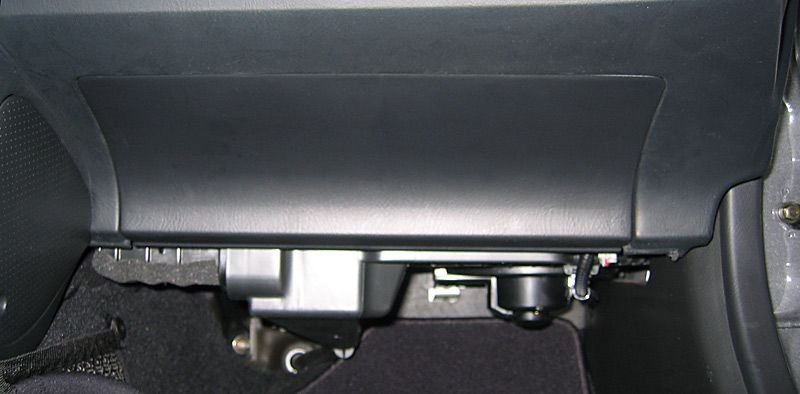

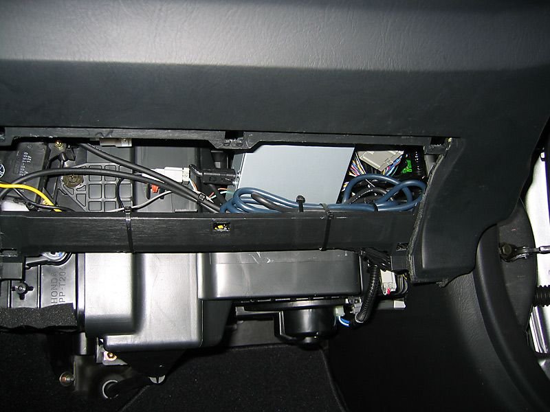

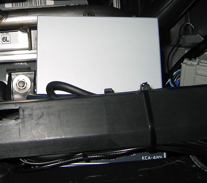

Mine is located under the dashboard on the passenger side. There is an access panel just above the passenger footwell under the dashboard and my sat radio adapter sits right inside of there. My antenna is on top of the dashboard in the middle just behind the windshield, so the wiring just goes up through the dash.

Hokay - got some pictures.
Location of Lower Dash Panel:
Panel opened showing Satellite unit:
Detail of mount - note screw at the top of the Satellite unit into the rail:
