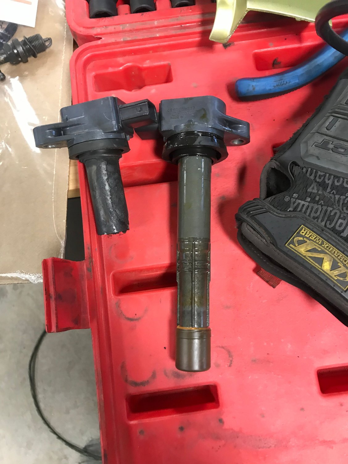

code said misfire in 3 and this is what came out (left side) Then the other one is oil in 1. Most likely oil in the rest of them.

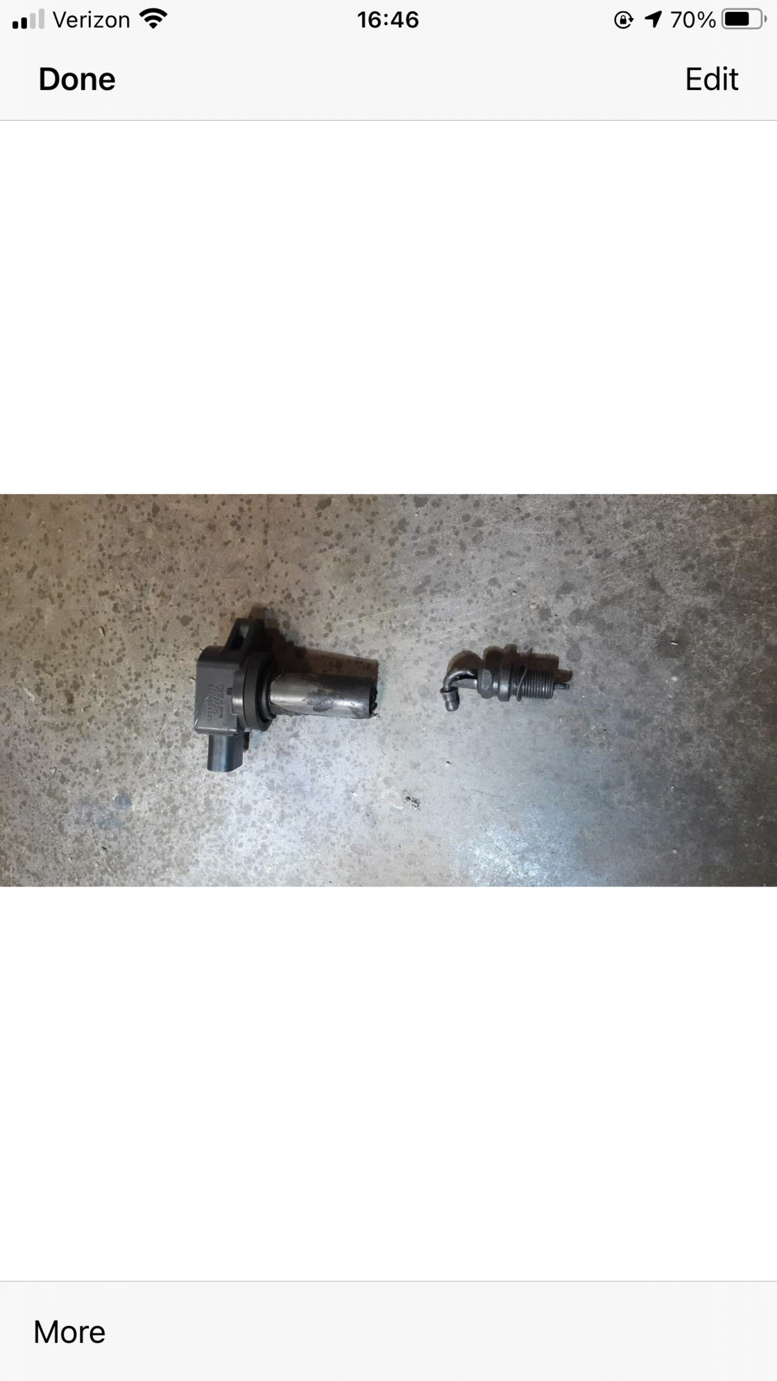

This is the spark plug..no damage to piston. Hopefully mechanic can fix it. If not going to take head off and look at what else can be done..

Was the plug loose when you removed it? Or still torqued down properly?
Oil in the tubes can just be tube seals (no need to pull the head)
Concern would be if the plug was loose in the hole. If so, it could have messed up the threads in the head. If the plug was tight, I would replace the tube seals to stop the oil leak, replace the plugs and the bad coil and then see how it does from there.

Don't see a spark plug in either photo. How did they all look? Seals are probably fossilized with oil on the coils..
-- Chuck
There is a plug in the last photo. It is just broken. That is the part that leads me to think the plug came loose and started trying to back out while running and eventually cracked the ceramic on it.

Thanks, can see it now. Is the spark plug in 2 pieces overlaid on each other? The bottom half (right side in photo) is recognizable but top looks weird.
