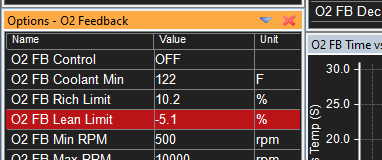

I downloaded the software to take a look, hmmm, makes me wonder if yours is set to prevent it from reducing fuel, maybe tuner set it to 0%?
In screenshot below you can tell on included by AEM base map for SC AP1 it's limited to cutting 5.1% of fuel and no more.
UNLESS you are not actually looking at % values? Just double-check exactly what it is that the O2 FB window is displaying for a value. Maybe it's LAMBDA? Just a wild guess. I would need to see it to understand.

It was a stupid mistake. My lean limit value did not have a negative sign in front of it. So when the software was trying to lean it was actually richening. I still don’t know why it’s so rich still though. Even if the o2 says it is 14.8 at idle you can still clearly smell fuel.
