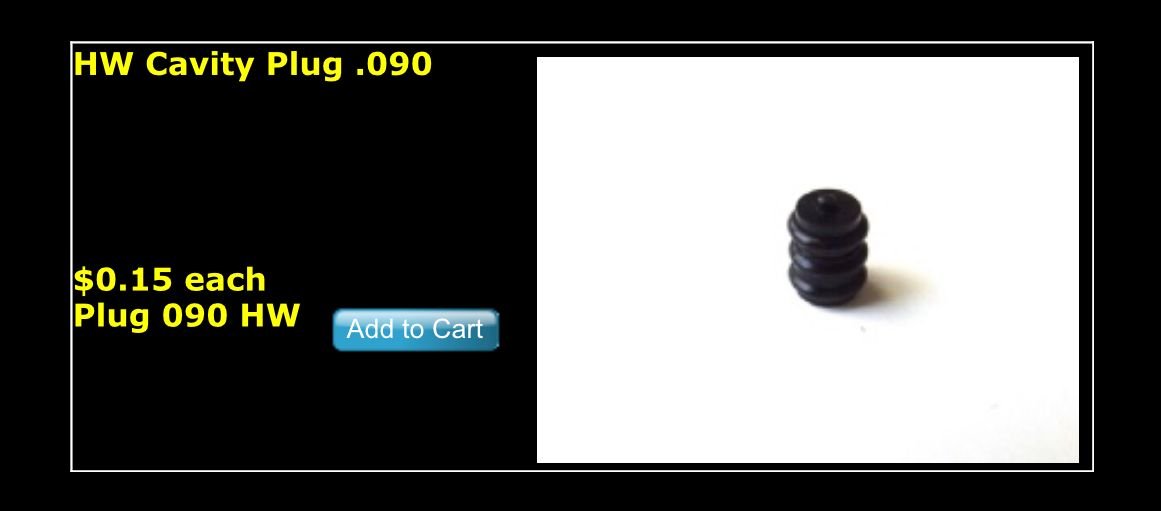

If you really want to be extra like me what I did was purchase the corresponding male/female connector that goes to what's being left unused & just use blanking grommets for where the wires would go into it.
www.cycleterminal.com has most of the connectors, just take the time to look through the site and match them up; he has very good photos of the connectors.
At the bottom of the page for the connector you need they usually have the corresponding pins & grommets available. You want to use the"cavity plug" instead.

Yeah, Joe over at cycleterminal has been very helpful with a couple other things I've done on the car. I actually thought about doing something along those lines with mating connectors. Unfortunately, there are at least a couple that are unique Honda connectors that don't have available options from Sumitomo, etc.
Thank you for the tips. It looks like taping them up is the common solution. I just wanted to make sure I wasn't missing some other sleek solution before I button things up.
