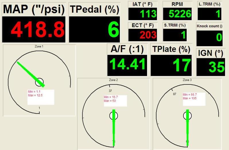

I started over on this today so that I could see how well Live Tuning would improve the process. I was BLOWN AWAY by how easy it is now. I created a modified version of the target throttle map with 3 zones so that I could cover much more of the load levels at once.
Then I created a display that would include 3 guages for throttle level so that I could see when I was within each of the zones. The first guage shows when the throttle is between 1.1% and 12.5%, the second shows when it is between 16.7% and 50%, and the third shows when it is between 66.7% and 100%. Note that you need to avoid the gaps between the zones (12.5-16.7 and 50-66.7), since the DBW system will interpolate and screw up the manifold pressure. When datalogging, it can be difficult to stay in the zones, but try to keep the zone guages in the middle. There seems to be some strange behaviors in the target throttle mapping that I've tried reporting to Hondata months ago, but since it doesn't impact "regular" driving, they haven't responded. One thing to note in particular is that the right 4 columns (75%-100%) seem to be broken, since you can't achieve zone 3 unless it starts on column 66.7.
I drove around an undeveloped subdivision for about 10 minutes hitting all 3 zones several times from about 1500 RPMs to 7000 RPMs, then looked at the suggested fuel changes. They looked VERY GOOD, so I applied them via Live Tuning (Very Nice!) where the obvious trends were, and extended those trends to the right-most columns (high load).
Then I drove around again for another 10 minutes, and checked out the new suggested fuel changes. They looked even better, so I applied the trends again.
Then I drove around again for another 10 minutes, and checked them again. I couldn't believe my friggin' eyes!
I plan to shift the target throttle map up so that the 3 zones fall between and above the previous zones so that I can verify that the interpolation went well.
