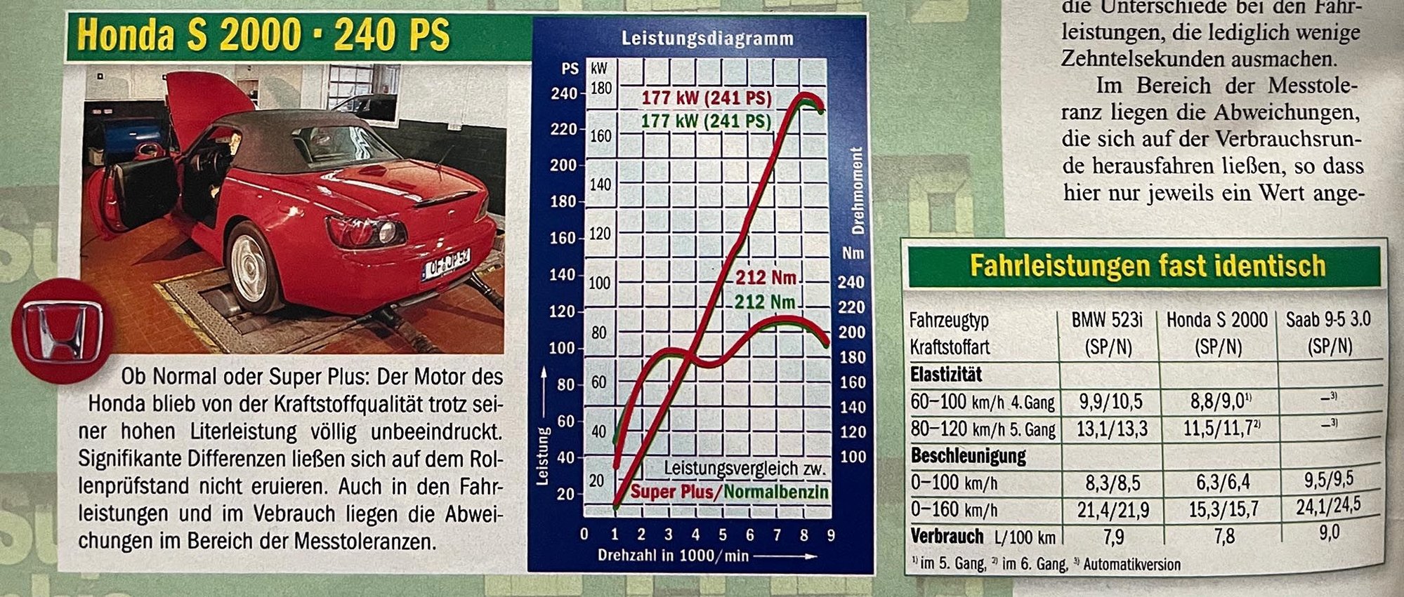

Note the difference in Octane rating in the german owners manual between the F20C1 and F20C2 engine. Wich one was sold is the US?
I once read a copy of a car magazine test from a german Magazine. I am looking for a copy of the test, but i give up. It was somewhere in the german S2000 forum, but i am no member there anymore.
If Memory serves me, they used a S2000 on a Dyno to see wich difference the - back then - 3 different fuels we had make. We had regular 91 ROZ, Super 95 ROZ and Super Plus 98 ROZ available back then.
91 is gone in the meanwhille. Test showed that there was almost no difference in Power output and no signs of problems with the engine. The Knock sensor did a good job adjusting the ignition timing.
Nevertheless i am sceptical, i would never run the F20C engine long term with 91 ROZ / 87 Octan US

Found the test!
My memory was not 100% precise. They used Super Plus 98 Euro RON vs. Regular (Normal) 91 Euro RON. Thats about 87 and 94 US octane.
The acceleration is a little bit slower, but they stated that this is within the tolerances. ( Wich i doubt )
