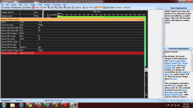

Assuming you have a boost solenoid as well, you can set up a high and low boost switch. The switch will need to be wired into the D connector into the EMS as a switched input. You can set up the switch so that when the wire to the EMS gets grounded, it activates high boost.

Thats exactly what I did. However I lost that function when I used my nitrous map as my failsafe for my methanol setup. Basically it's a switch to ground, you flip it, the ems see's the ground and switches, behaves the same as my meth setup failsafe.
I picked up a simple switch @ radio shack, and wired it in.

This is what it will look like. If you look at the bottom part of the list.
