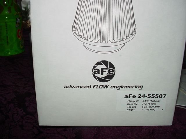

I don't want to get in a debate over Gauze vs Foam but after looking at several K&N filters with no fitment, I decided to give AFE a shot and found the info here on the boards (thanks to SCHighlander).
I have heard good things about AFE so I purchased it at Sparkplugs.com for $40.00.
I have had great luck with Gauze types in all my engines for years and this looks like a quality piece!
This is the recharge kit
http://www.sparkplugs.com/more_info.asp?pid=7496
This is the filter
http://www.sparkplugs.com/results_cross.as...55507&x=48&y=12

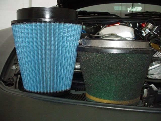

The Old foam Comptech filter
Flange to Flange (identical)
Side by side

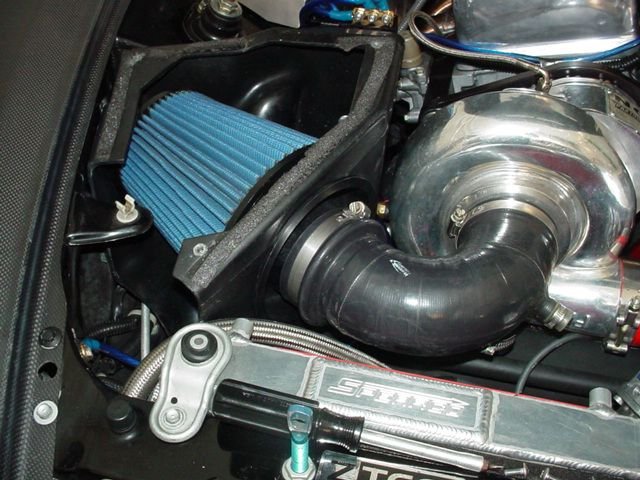

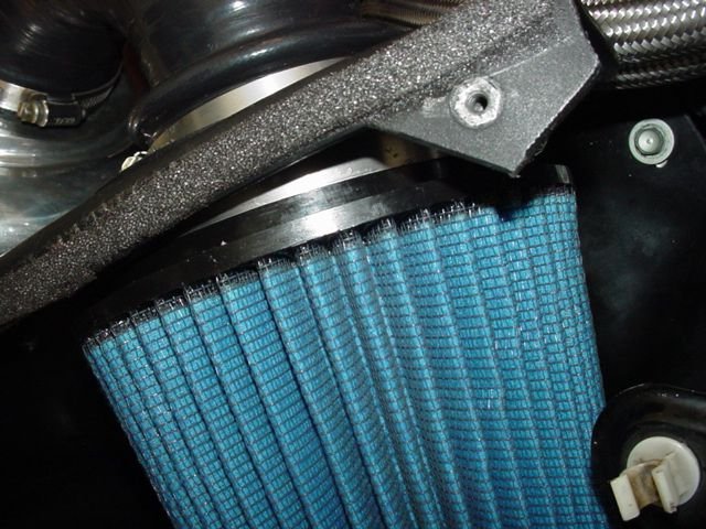

Make sure the clamp is at the end of the flange tight against the airbox

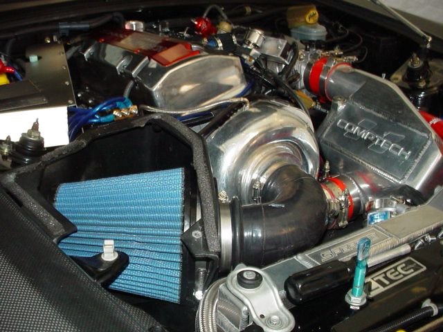

It is tight but it fits the filter is huge!

Is the diameter of the filter at it's widest point bigger than the Comptech?
If it is....it won't fit with the cover on. The Comptech filter is almost flush with the top cover when it's screwed down. Any filter wider in diameter will not fit.
Can you confirm?...
Looks good though..
Old Oct 19, 2005 | 11:44 AM
Ztec's Avatar
Posts: 2,554
From: Orlando, Florida
My cover fit just fine look at the 3rd pic of the flanges - the widest part is the same size!

Nice find.
In the Sparkplugs.com link, type the P/N from the box; 24-55507
