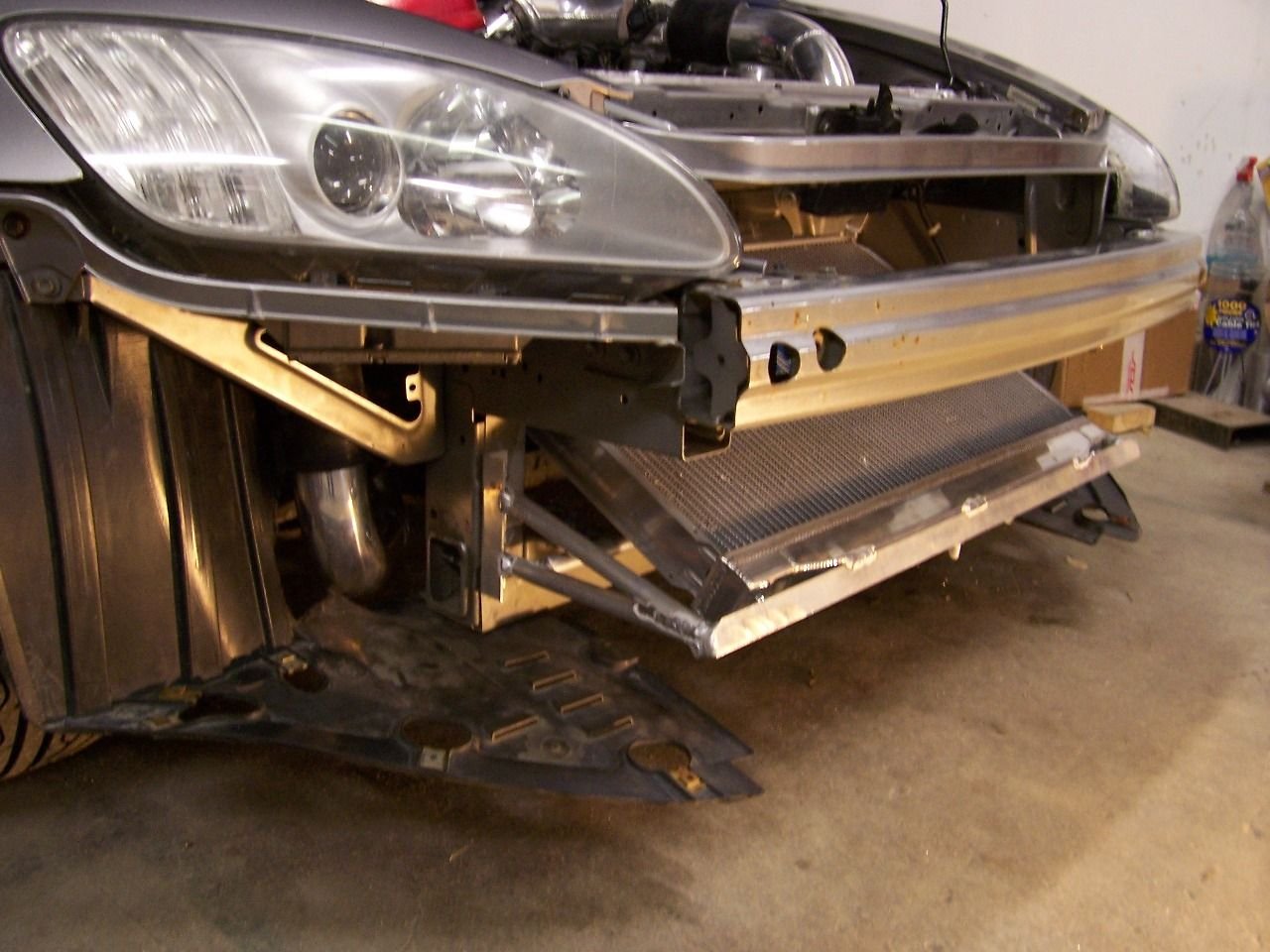

The new Lovefab Manifold
GT 35R
V-mount intercooler/koyo radiator
Hypertune intake manifold
Hondata gasket
AEM EMS w/ Wideband
AEM boost control soloniod
It made 358hp/226tq @ 10psi
And yes, I drive it every single day
I'll put more up later.

That's sweet looking and I love the V-mount intercooler setup!
I wonder why your power is only 358 whp at 10 psi? I would have thought you'd be at least around 390 whp.

killer setup but i would be expecting more from a killer setup like that?

cody was saying the dyno numbers were low and it should actually be 380 - 390 but the graph itself says 358. Stock compression bye the way, for now.

seems like a very efficient setup. With stock compression I would expect it to break 400 at the wheels at those boost levels. Looks amazing.

set-up looks real good but I was expecting more just by looking at these pics
