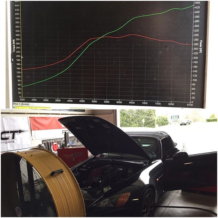

Installed back in late 2014 SOS TS max turbo kit, GTX3576R, ran the previous owners map until dyno on April 22nd 2017 @ Evans Tunning in PA Made 430 HP on a dynapack @ 13-15 lbs, boost by gear.

Koyo Rad
93 pump
I did relocate IAT to intake pipe. Had videos on my IG, but I recently deactivated it for reasons...
This is from evans IG, april 22nd 2017
