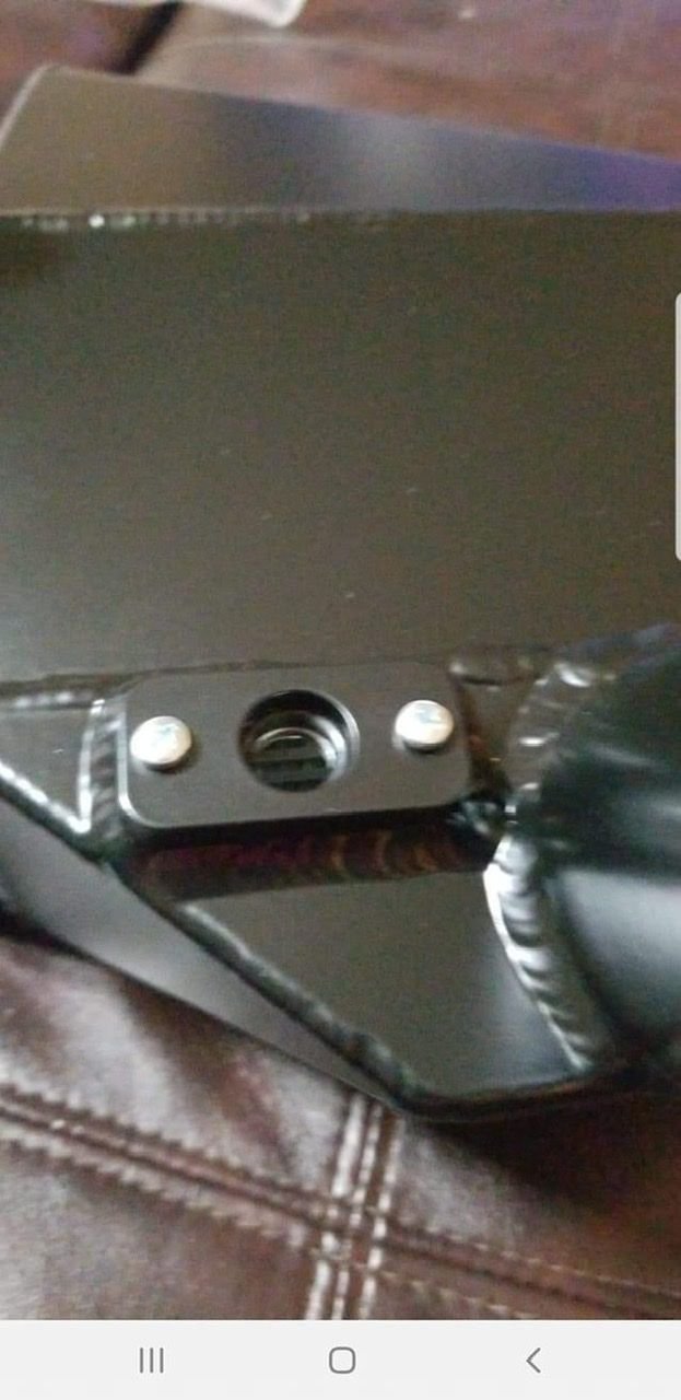

The newer SOS kit has the option for them to weld a bung to the backside of the cooler right next to the outlet.
https://www.scienceofspeed.com/index...0-2006-09.html
