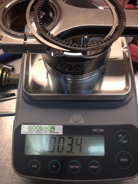

I Manage a Performance Machine Shop and Garage and I am in the middle of building a F20/F24 with H-Beams and Wiseco Pistons, You don't wanna skip this step! It will cost you $175-225 depending where you live and if they have to add any mallory or take metal away. 4 Cyl usually don't get static balanced like a V8 but you need to get your crank Balanced Dynamically.
Everything will have to be weight and takin into consideration, Flywheel/Flexplate, conrods, Bearings, Pistons, Rings, wrist pins, Locks, even clean, wash and dry your parts from oil before you weigh it. All rods and piston have to match each other within 1-2 grams,
Dont quote me word for word, I'm just the manager at our shop but thats what we had to do.
