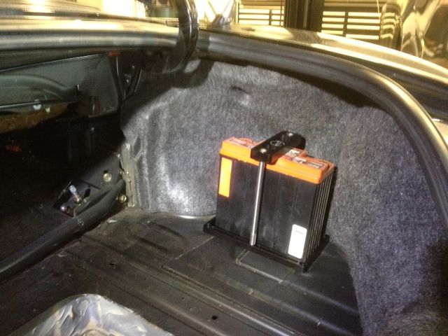

Here are a few locations in the trunk where we could mount the battery tray. We could also mount it in the spare tire cavity but that would require running something smaller in size than the Odyssey PC680, if you want to keep the 500+ CCA amp, the largest shorai or Ballistic evo2HD are both shorter in height and can probably fit in the spare tire cavity. Regardless of location, it will require drilling holes in trunk sheetmetal and using either thru bolts or rivetserts to secure the battery tray to the chassis. If we were to mount it in the factory location in the engine bay, we could build a mounting tray that could use the existing oem battery tray mounting points and no drilling would be require. But it sounds like everyone in this thread wants to mount the battery in the trunk.
MrC
Location 1:
Location 2:
Location 3:
Location 4:
Location 5:
The spare tire cavity will require using a smaller height battery since the PC680 is too tall.
Location 6:
