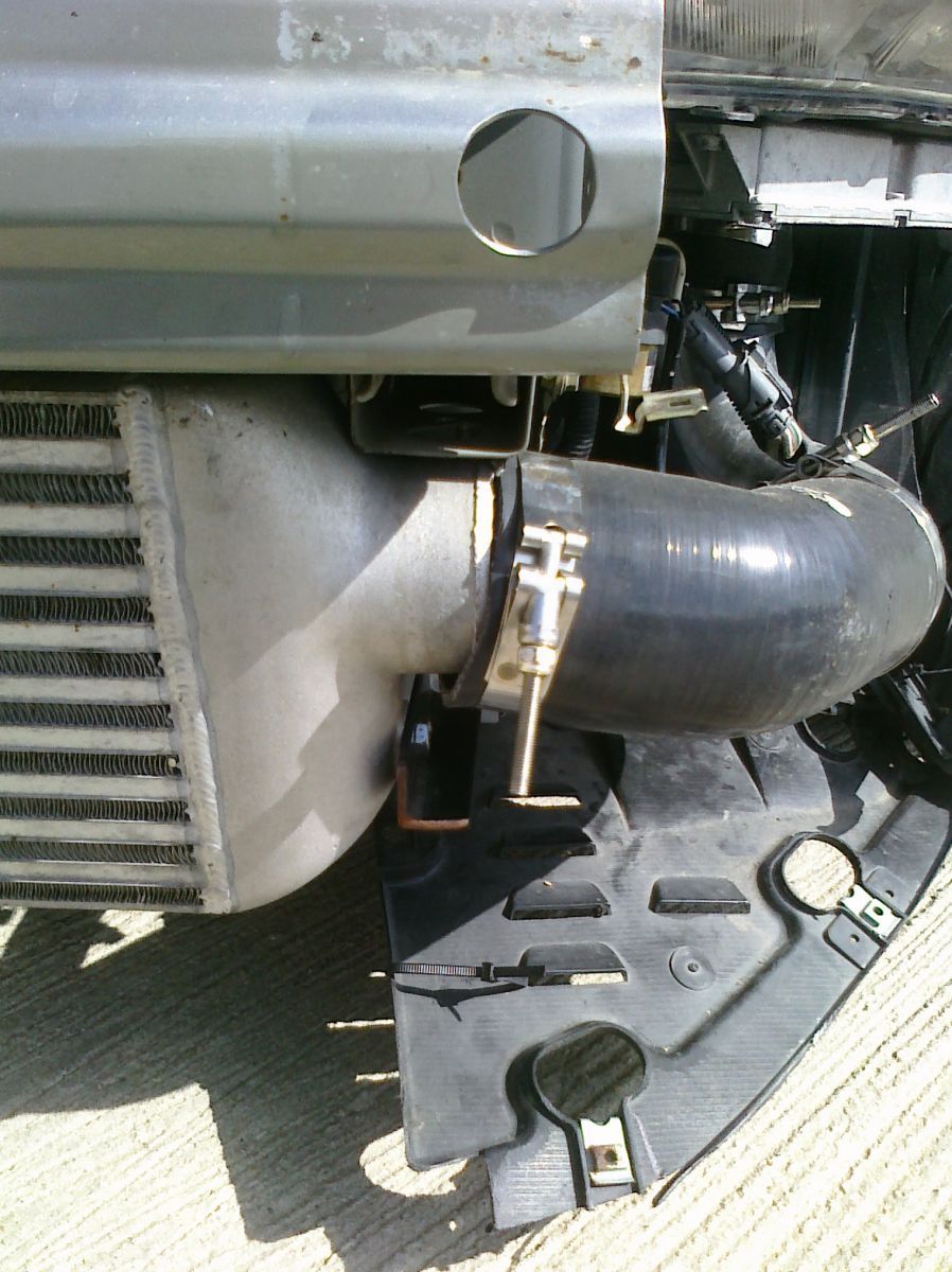

Originally Posted by DFWs2k,Jun 12 2010, 10:54 AM
my car's not holding boost now after i had the intercooler moved up a couple inches (was hanging below the bumper before relocating on 6/10)
the kid i had move the intercooler stripped 2 good clamps that I had, so I got a worm clamp from lowe's while waiting for him to get me another good clamp
the worm clamp blew off the first time i hit boost (later that day on 6/10)
so drove around not making much boost, and picked up the replacement clamp and put it on while on the way to a photoshoot/videoshoot (on 6/11)
tried to boost, and it seemed to hold it for a second, then it sounded like all the air gushed out, or a coupler popped. the one from turbo to intercooler has been the one causing me problems so far, but it looks fine, i wonder if that kid scratched/poked a hole in one of the other couplers....
hopefully its just some loose clamps, i think i'm only getting 1 psi, but i'm still trying to figure out how to configure the TV2 to show psi
oil was also changed at the same time intercooler was moved up

i think i'm only hitting 1 psi
yea all the intercooler piping has beads, where is the clamp supposed to be in relation to the bead? also, where am I supposed to clamp the coupler onto the turbo outlet? it's 2.5" at the furthest out point because of the little lip or whatever, and it's skinnier if you move in towards the turbo

pretty sure i found my problem, yall think this would result in not seeing very much boost?

^^lol!
that would do it. just disassembled stuff till you found it? or?..

just took off my front bumper to check all the connections since the kid took all the intercooler stuff apart to move it up, and lo and behold, upon examination the problem was quite evident

classic. glad you found it bro. get that beast back on and get back out on the prowl.
