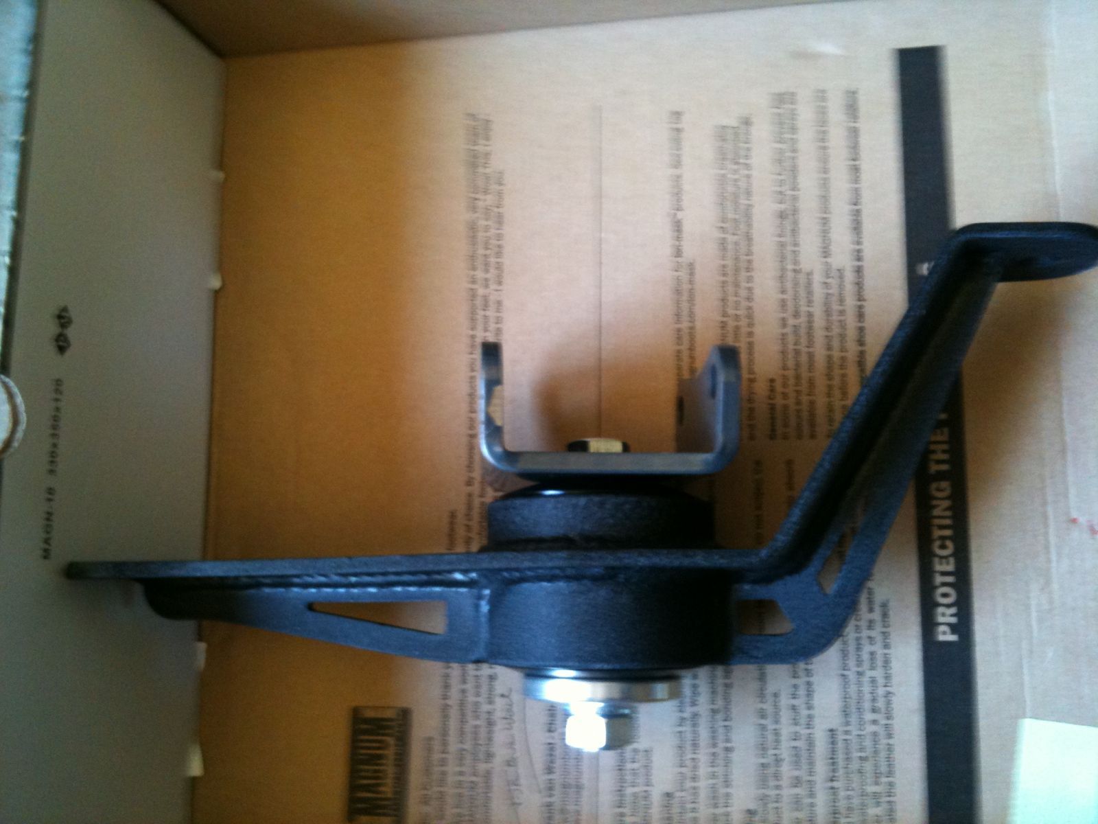

I had been noticing alot of movement whilst putting the power down and also coming off the power so i ordered some new mounts
So i changed these
Anything wrong with them ??? lol
for these 75a Innovative mounts
Hopefully this will help with the problems i was having with bolts from the turbo and manifold backing out

they are very er lets say stiff
hopefully they will bed in alittle

i would have to agree with you on the WOT and gear changing, the car feels great, there is some vibration and noise level rise, i have hardtop on at moment aswell but only driven 10 miles with them on at moment so give them a few weeks

how hard was the install? does the motor have to be raised, and if so how much?
Old Jan 31, 2010 | 12:31 PM
phils2k's Avatar
Joined: Jun 2005
Posts: 2,670
From: south east
I used a engine crane lifted it about 2 inches. Very easy to do took about three hours all in all

75a's are the softest version?
Old Jan 31, 2010 | 12:40 PM
phils2k's Avatar
Joined: Jun 2005
Posts: 2,670
From: south east
no
60a street
75a track
85a race
95a extreme
the mounts are colour coded
