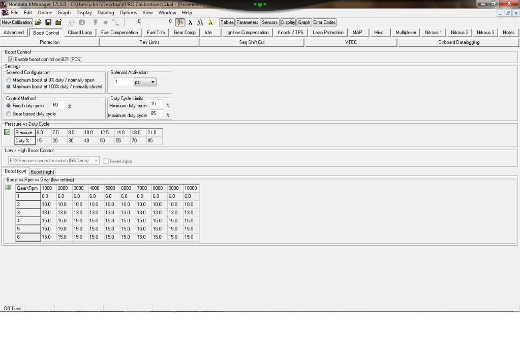

I'm running KPRO. Here are my current boost settings.

Turn on boost by gear and give it less boost in the gears and rpm ranges where its creeping

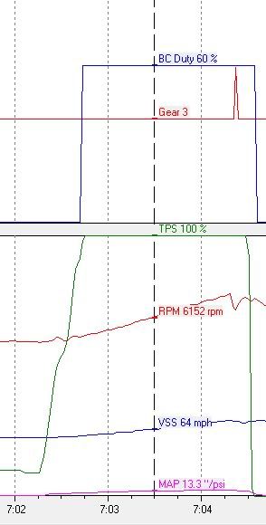

I might just do that. Here's a datalog I took showing WOT in 3rd gear. When the rpm (red) just drops off is where it cuts. At that point I was as 18.2psi. What would you set your boost by gear at spec?

How's this look spectacle? Anything I'm missing?
