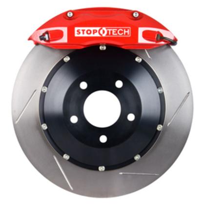

Definitely a Stoptech BBK The 2 piece calipers and rotors will help dissipate heat on the track.
http://store.excelerateperformance.c.../i-214367.aspx
