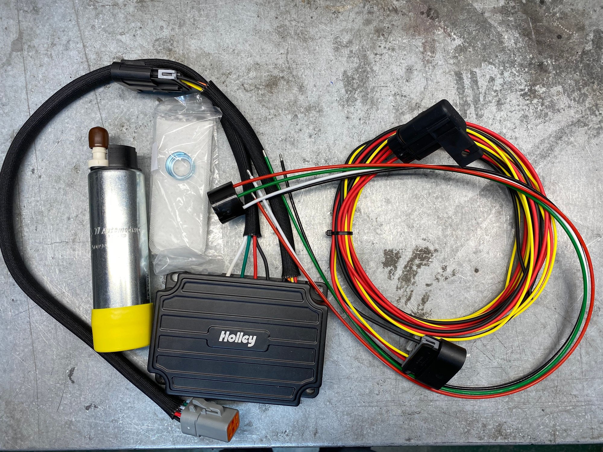

The Holley VR1 kit showed up today. Once I get the Walbro 450 out of my tank I'll take pics comparing the TI brushless pump, 450, and stock pump all next to each other.

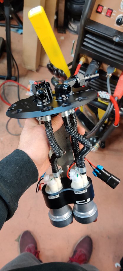

I really don't want to deal with 2 pumps and a hanger that is guaranteed to leak when I can use one pump that will flow as much or more. The dual stage controller will be a nice bonus. With this brushless pump, I have the ability to expand and increase fuel flow in the future, either with a voltage booster, or by swapping to a different controller all together. The ID controller looks really badass, but I'm going to guess it will be very very expensive too.
A hanger that is guaranteed to leak? I have that hanger and I can tell you this thing wont be leaking any time soon lol. However, that stock plastic hanger you are about to drill to make work with that brushless pump....that is questionable.

Meaning the Full Blown hanger that everyone complains about how they leak. The CJM hanger, according to CJM themselves, won't fit dual 525s, and I don't have the resources to fabricate a spacer to mount them to their hanger, nor should I have to if I'm spending that much on a fuel pump hanger. So, neither or those are options for my wants and needs.

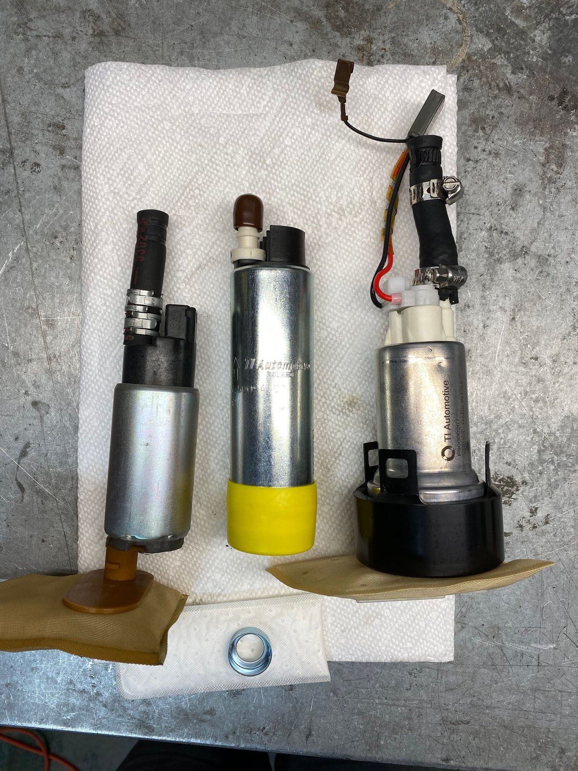

Here's a comparison pic from left to right: stock pump, TI brushless pump, Walbro 450. One thing I don't understand with the TI brushless pump is that it just has a 3/8" barb outlet when the selection chart and instructions say that it is supposed to have a -10an inlet and outlet. Not sure what the deal is there.
