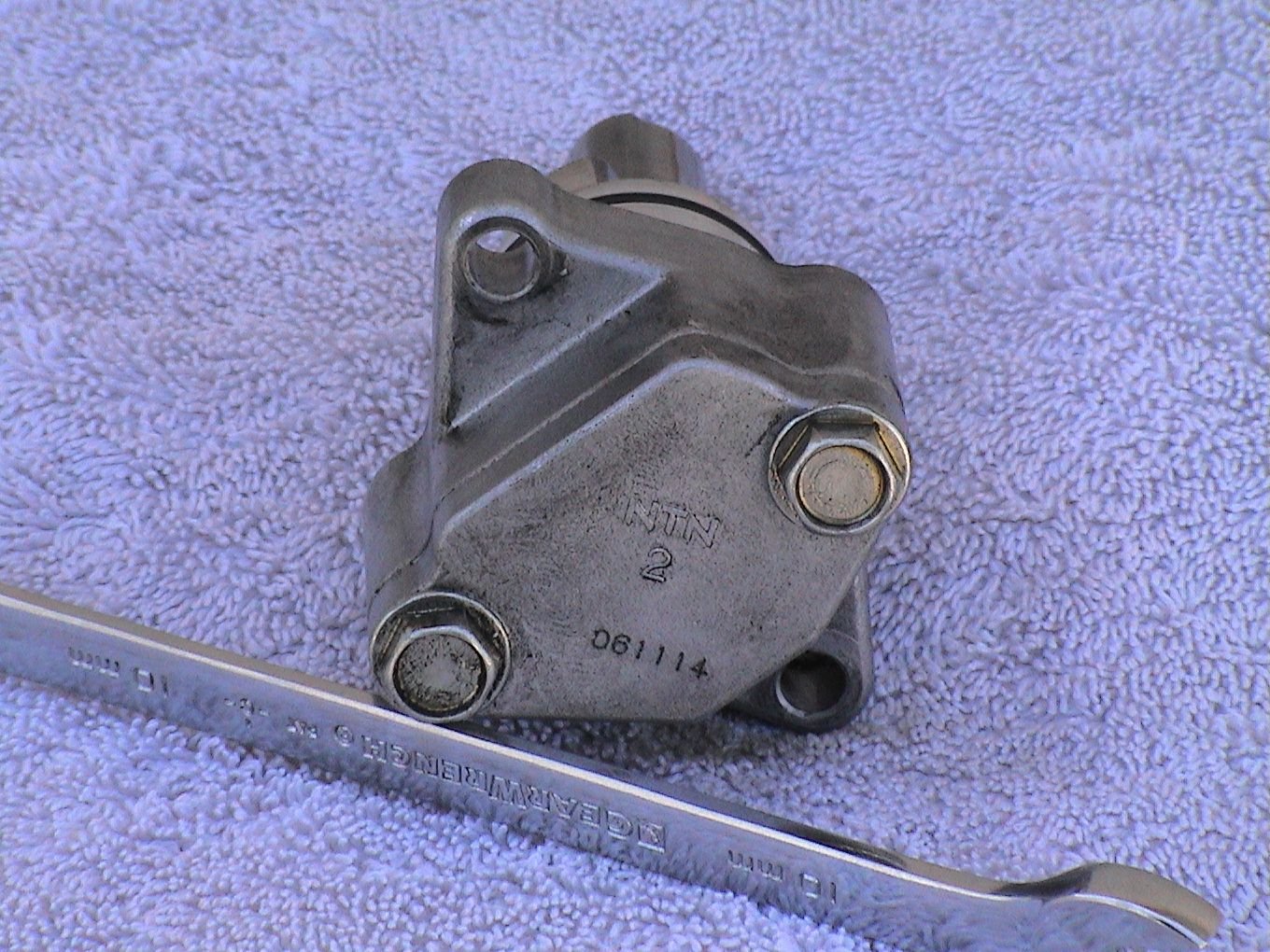

There are 4 bolts on it. All 10mm wrench or socket.
Two bolts hold the TCT to the engine. In this photo there are 3 bolts lined up and only the two lower are the TCT. The top one is on the Vtec solenoid.
Remove the two bolts holding the TCT to the engine and leave the two that hold the small plate in place. Gently remove the TCT keeping the assembly together. I suggest a shop towel or rag for the oil that will drain from the TCT when removed. The towel can catch the parts that fly out when it comes loose. I've lost several in the past.

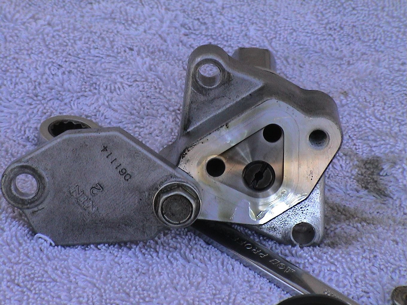

There is a small plate on the tensioner held on with two bolts and using an O-ring. Loosen the bolt on the left side two turns then remove the bolt on the right side.
Swivel the plate down.

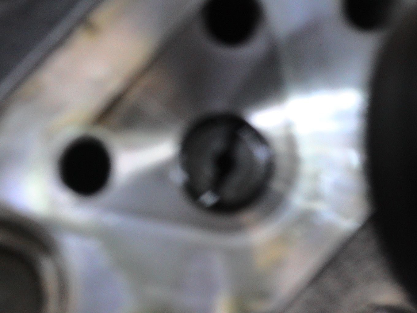

Using a large screw driver remove the oil jet.
Insert the M5 bolt and engage the threads internally until finger snug. Use the nut to hold it in place. This holds the assembly together.
On a new TCT insert the M5 bolt assembly and make finger tight. Release the pin.
Install TCT with the plate open and the M5 installed holding the assembly tight. After tightening the 2 bolts holding the tensioner to the head, release the internal assembly by removing the M5 bolt assembly.
Install the oil jet back where the M5 was.
Gently swivel the plate back up and over the O-ring and install the bolt. Make sure the O-ring in the plate is in place. Tighten both bolts holding the plate on.
You are done if you re-inserted the oil jet. It you didn't, go do it now.
