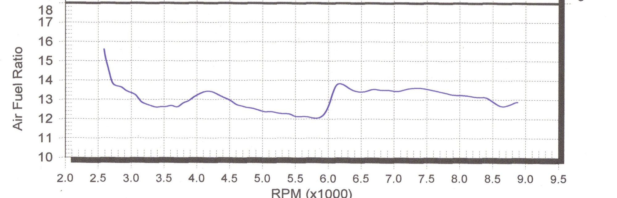

It was taken apart to make the adjustment. I believe they used shims or just stretched the spring inside the regulator. I will post 2 dyno runs to show where the A/F started and where it ended up.
Initial Setup

Doesn't look too rich to me. You should let the tuner shop know it threw those codes. Do you have any other piggy back type ECUs at work? Check the wiring on the black boxes.

sstone, I hope u are on race gas or not boosting...those AF seem a bit high for the streets..both codes are rather common though. Try using a 18mm spark plug anti fouler as a mechanical O2 simulator...

So the ECU thinks the car is running rich, but it is still running to lean? I am not sure from the responses which side of the equation my car is on. Is my cars A/F in a dangerous area?
