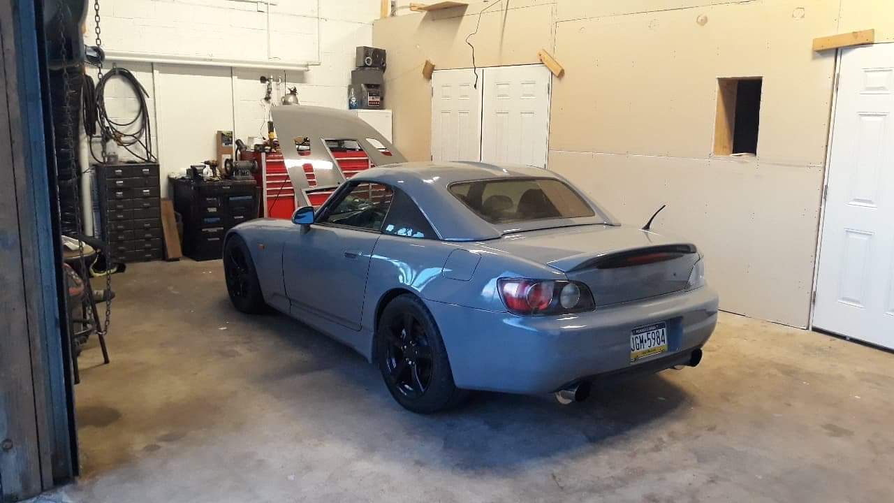

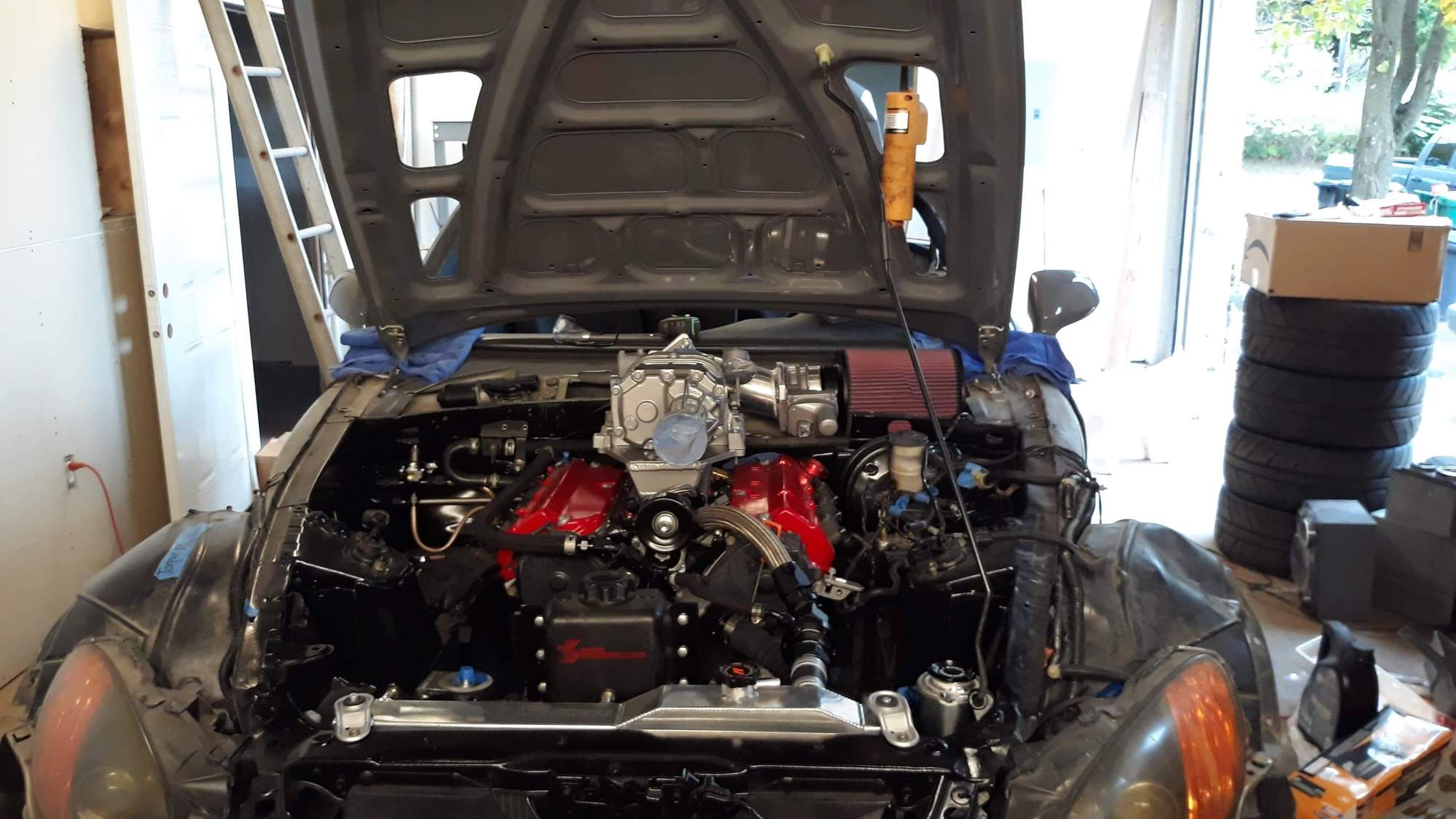

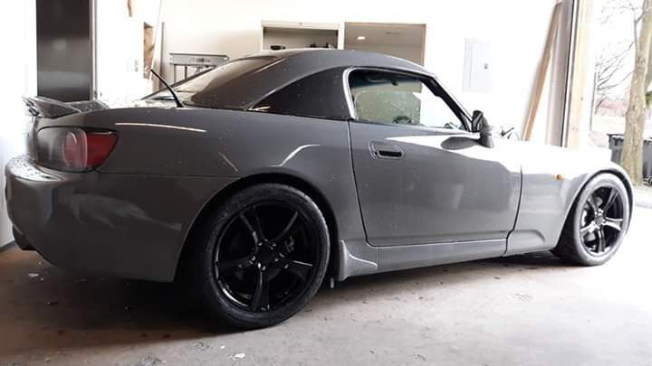

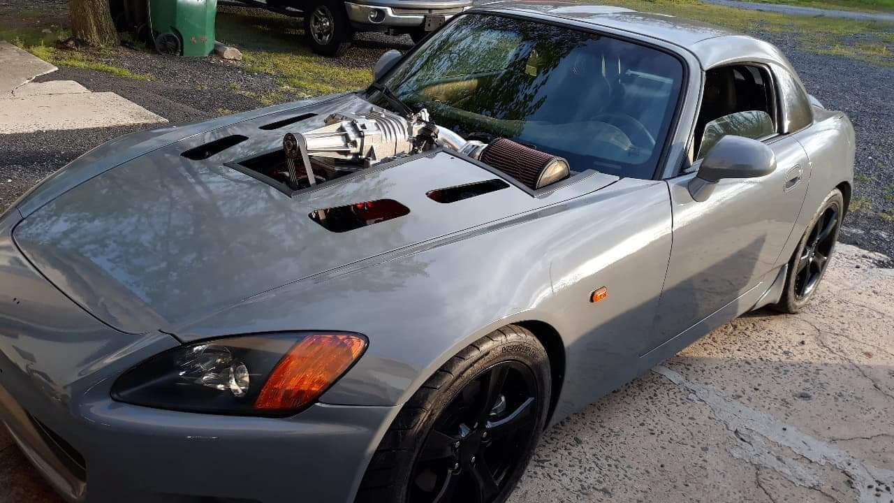

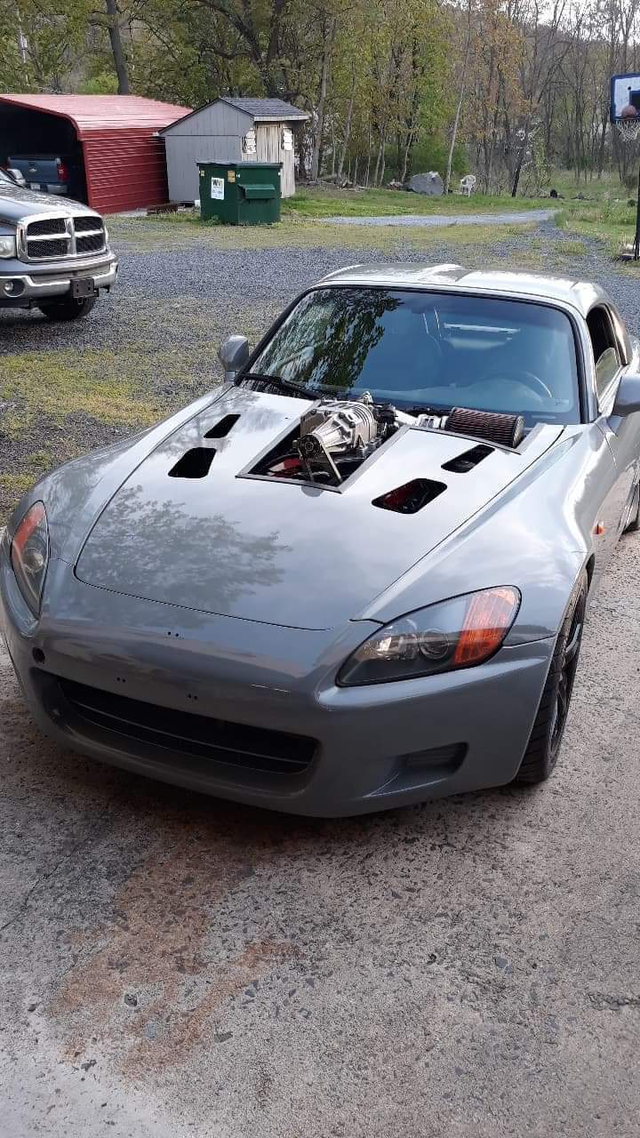

Hello S2ki family I'm back with a new build! Just got finished at Evans Tuning a few days ago!
- J35a3 unknown miles
- Supertech springs and retainers

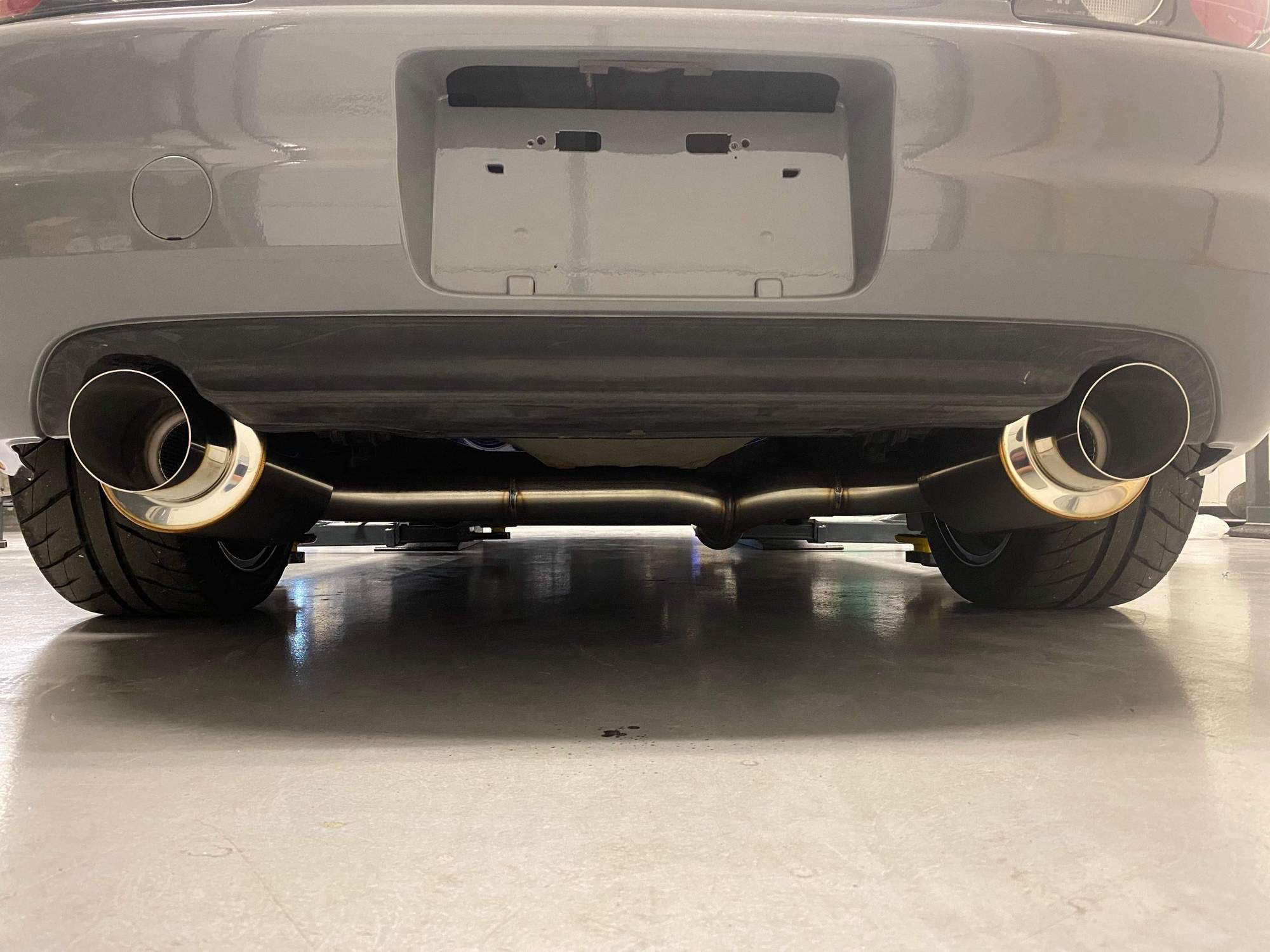

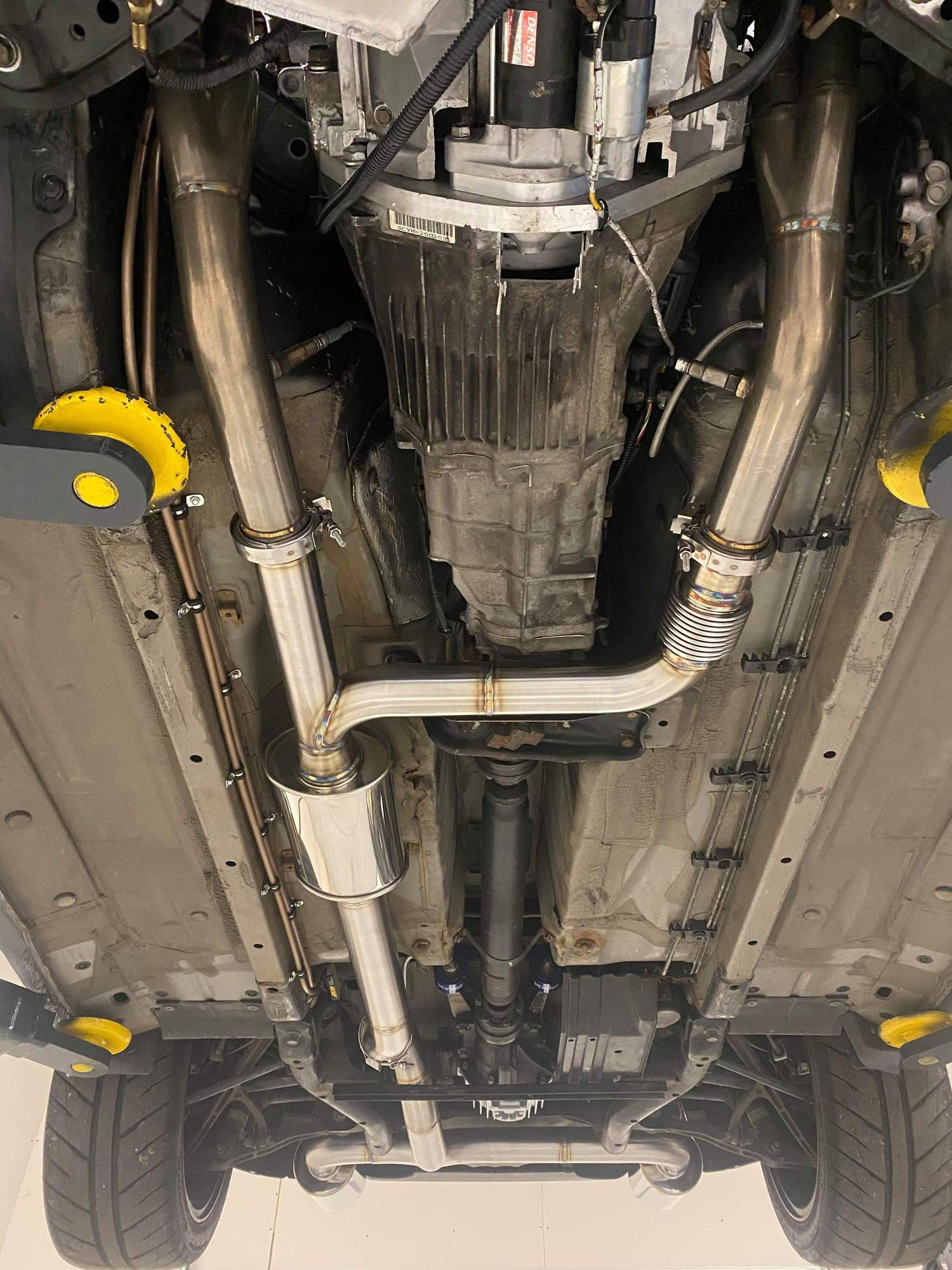

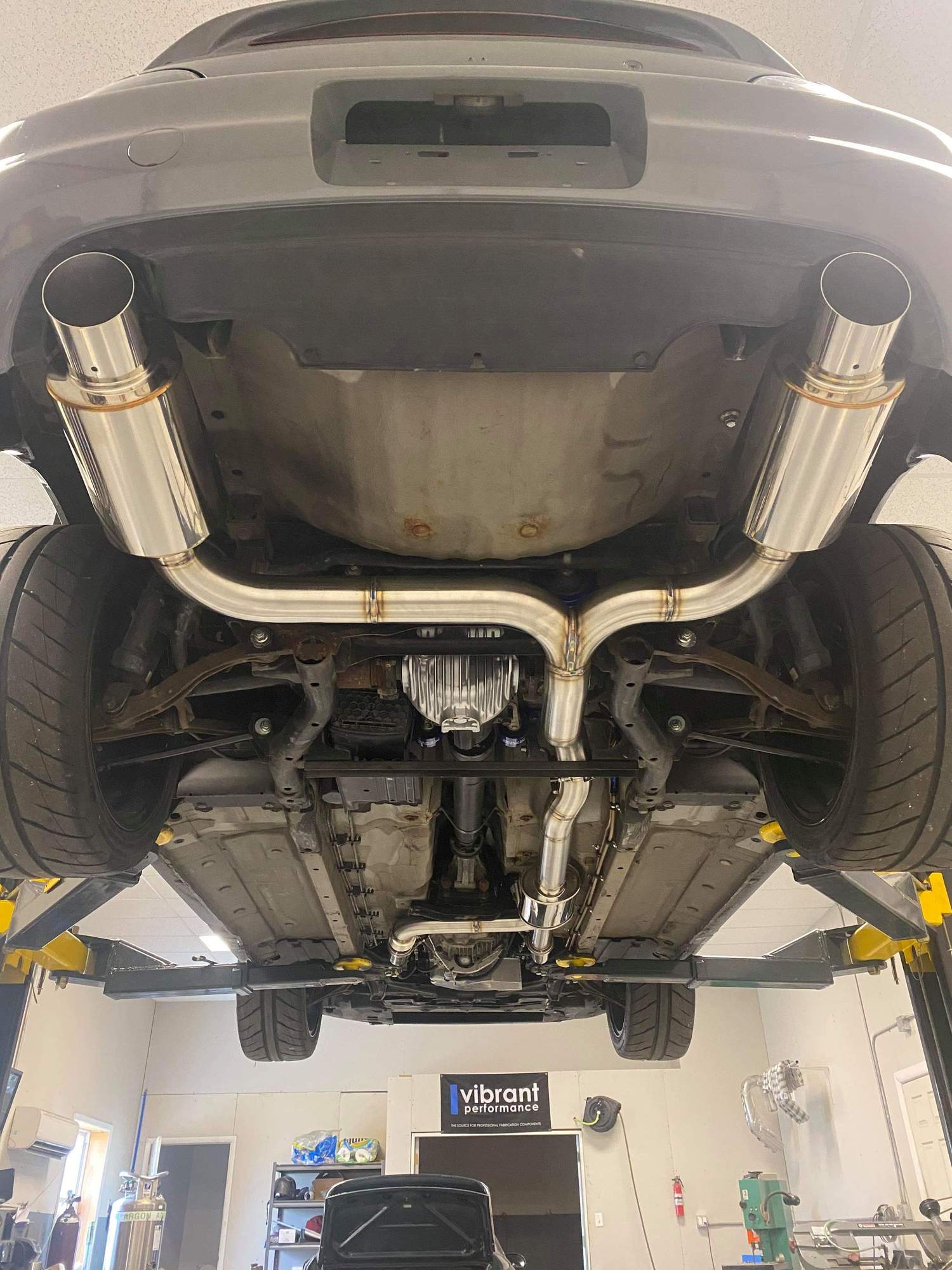

- Schmuck Built 2.5" headers and 3" dual outlet stainless exhaust
- Aem Infinity

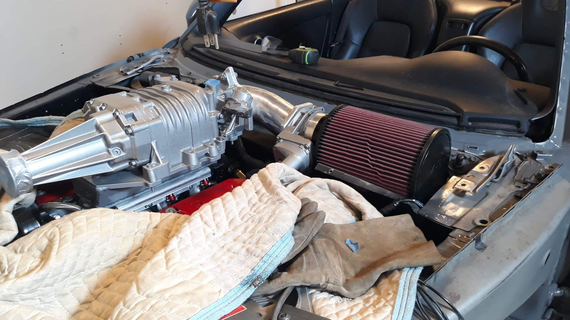

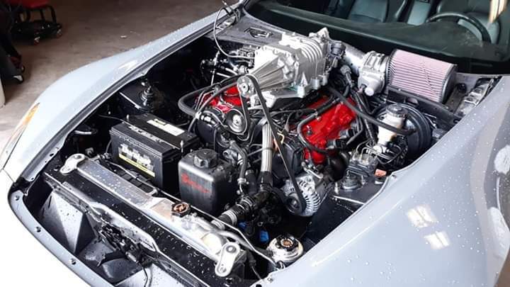

- Minitec M90 manifold and kit
- Inline Pro J Swap Kit
- Clutchmasters Stage 4
- PuddyMod Stage 2 Diff 3.7 Final Drive
- Stock trans and axles
- Jon Bond built and ported M90 Supercharger ( I used this because it was an off the shelf bolt on to he Minitec kit )
- 2.5" Pulley boys microwelded pulley ( overspinning blower )
- Snow Performance twin nozzles ( 600cc total )
- LS3 90mm DBW TB and LS3 DBW Pedal along with cut fire wall, one off welded 90mm intake pipe, rewelded and relocated wiper rods and motor
- ID1300X Injectors
- Twin Aem 320 pumps
- 8an feed 6an return all NICOPP hardlines! Bent by me
- 93 and E85 tuned Aem Flex Sensor
- P2R Fuel Rails
- Mishimoto Rad
- bunch of other sensors and expensive parts!

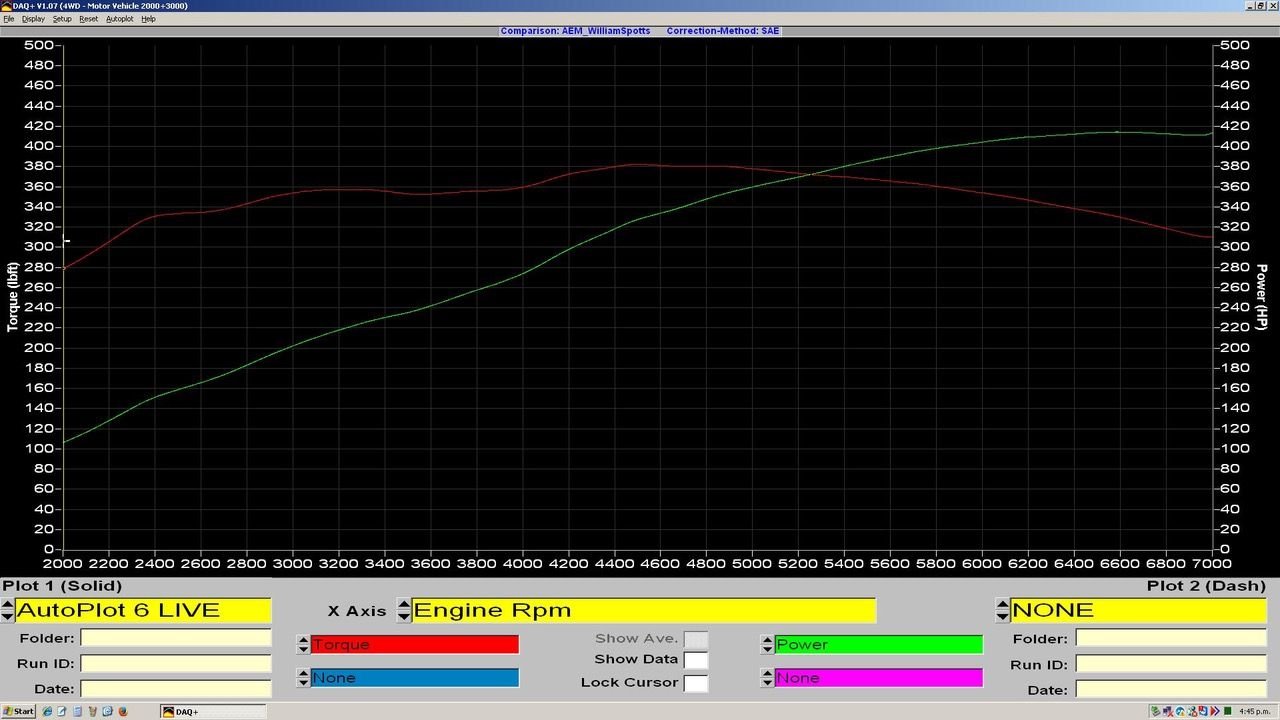

***Tuned in 98* heat with 68% humidity obviously not optimal tuning weather***
93 octane yielded 359whp 319tq
E85 yielded 418whp 382tq!!!
I'm would go as far to say you could add 20whp and 20tq to these numbers and that's a "reasonable" assumption to what it would make on the dyno with better weather conditions.
So 440whp and 400tq is what I'm going to be saying from now on.
The blower is maxed out at this point and is the limit on the current setup. In the future I will upgrade to a larger TVS or Whipple blower. But for now I'm just happy to be driving the car its been over a year I've been working on this setup.
Comparing this setup to my previous Inline Pro 2.4 stroker and SOT Mp62 kit. On average I gained 100whp and 150tq across the entire powerband. 360tq at 3krpm with instant boost! Big fat tq curve!

Pretty cool, but why not a turbo or centrifugal SC? Then nothing sticking out of the hood.
