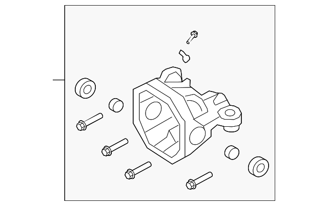

5thgen thank you very much for the reply, I think you are rite although it looks like ford were running with two designs at once at one point as I have also seen the diff with only one mount at the front?
I believe the earlier versions (02-06?) use the older, one-tab mount carrier housing.
And Ford's illustration of this is just the worst I've seen.
