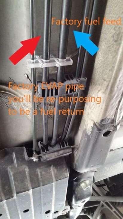

If you get rid of the evap system, you'll then be able to utilize the factory hard pipe under the car as a return line. This pipe is physically larger in ID than the return line on an Ap1 return system; I believe it's 3/8 vs the AP1 5/16, which is actually quite substantial. I personally had problems with fuel pressure on my AP1 due to the return hard line simply being too small for me. I've also noticed the AP2 hard line for the fuel feed is pretty large; it almost looks like it'd be the equivalency of a -8 feed. So you can essentially consider yourself having a -8 feed and -6 return utilizing the factory feed hard pipe, and the factory evap hard pipe as a return fuel line.

All of this would comprehensively let you run a fuel return setup. The rail w/ plumbing kit will allow you to keep your factory pulsation damper on the front of the rail, you'll be receiving an adapter to adapt your current factory fuel feed hard line to a threaded fitting that will accept their PTFE hose assembly, and a fitting for the center of the rail to use that hose as your fuel feed. For your fuel return you'll be mounting the DMR on the rear of the rail and just run an AN female to male barb fitting off of the bottom of the supplied swivel banjo fitting supplied with it, and run rubber hose to the factory evap hard line and use EFI hose clamps on it. At the other end of the hard line at the back of the car do the same, rubber hose to your fuel basket and use EFI clamps to secure it.

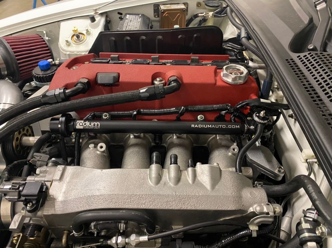

Here's a picture of my current setup using the 06-09 rail on my 02. I opted to run this rail because I personally think it's the cleanest fuel rail on the market in terms of not looking too busy. It'll be set up the exact same way on your car. I have the Radium pulse damper on the front of my rail, but you'll be able to run your factory damper with the included adapter. DMR and return at the rear of the rail, and the feed fitting can be seen in the middle.

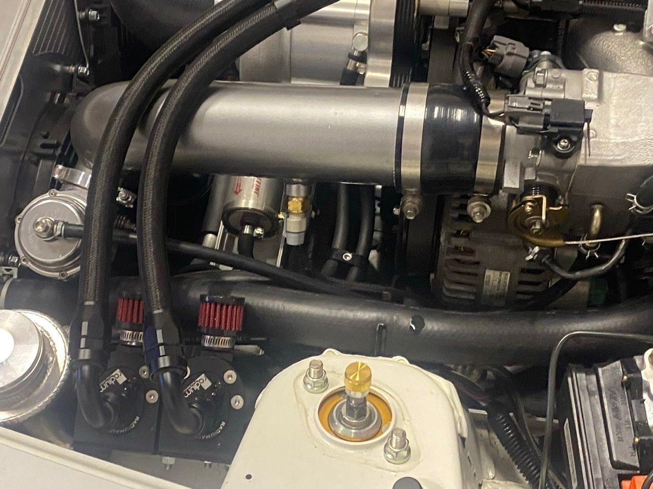

Also, with the EVAP hose gone off of the tube near the front of the intake manifold, you can then utilize that tube as your BOV vacuum line; literally shortest & cleanest vacuum line to your BOV ever. Here's how it is on my car:
Also, just to give you a visual representation of what I'm talking about, I pulled some photos from this guy's thread. Smart dude, made his own return setup on the cheap, but my way of going about it will be even less complex and much easier. https://www.s2ki.com/forums/s2000-mo...ystem-1197265/
