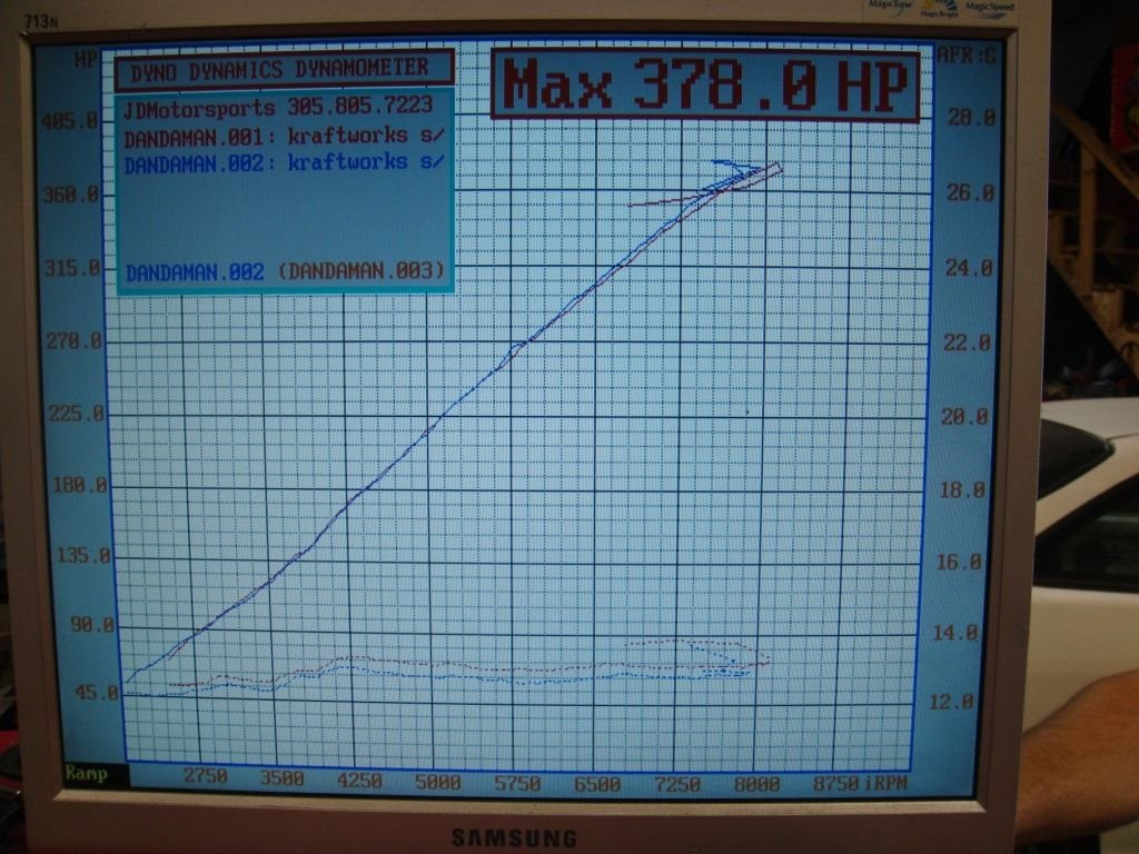

I dont want to sound like a POS, but ... 26X with an AC Comptech???? ... wow, I thought those would put you in the low 300s at least.
I dynoed 204 RWHP stock on a Dyno Dynamics / 378 RWHP SC'd, same dyno.
I would say dipping into the 13s is lean.

Bondo,
I am not going to knock your tuner because #1 I dont know him, and #2 I am not a tuner or someone in the position to talk about any tuner ...
Anyways, sorry about the confusion but my 378 was on a KW set-up.
I guess 264 with a 12% correction (I hear 11-13% on DD) would make it 296 RWHP. What PSI is that pulley giving?, it might be a low boost pulley.
I just thought Comptechs were usually in the low 300s but maybe I am wrong.
Again, dont take my comments personal ... they are just that comments.
Joaquin
PS, dyno:

Your plot looks like your A/F are above 12...
