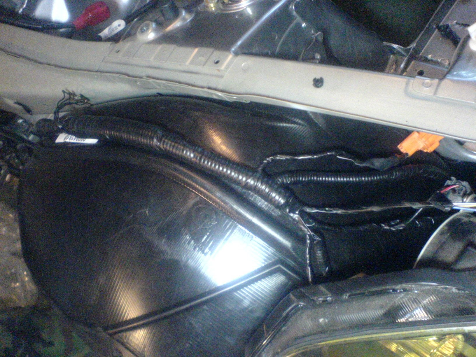

theres a few vacume lines u can cancel out, get the block off plate, if u really clean the engine bay then reroute the harness out of the engine bay, battery in the trunk, fuse box can go in a lot of places, i put mine on the passenger side floor
