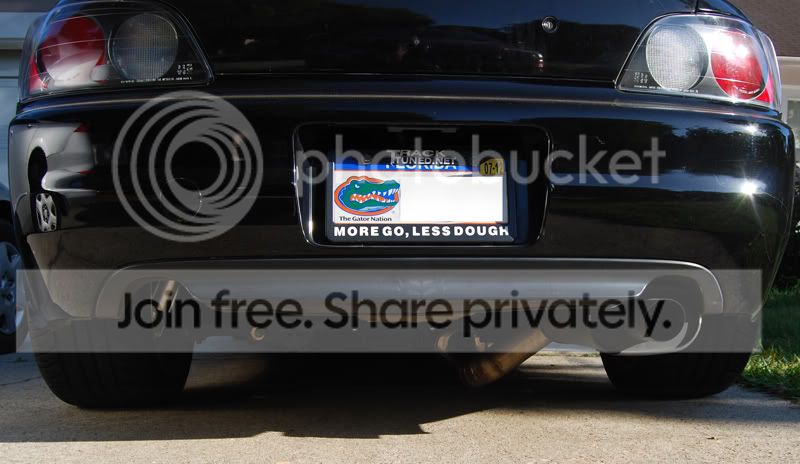

My current exhaust; eventually I'll ditch the exhaust completely and just run an uppipe through the hood
