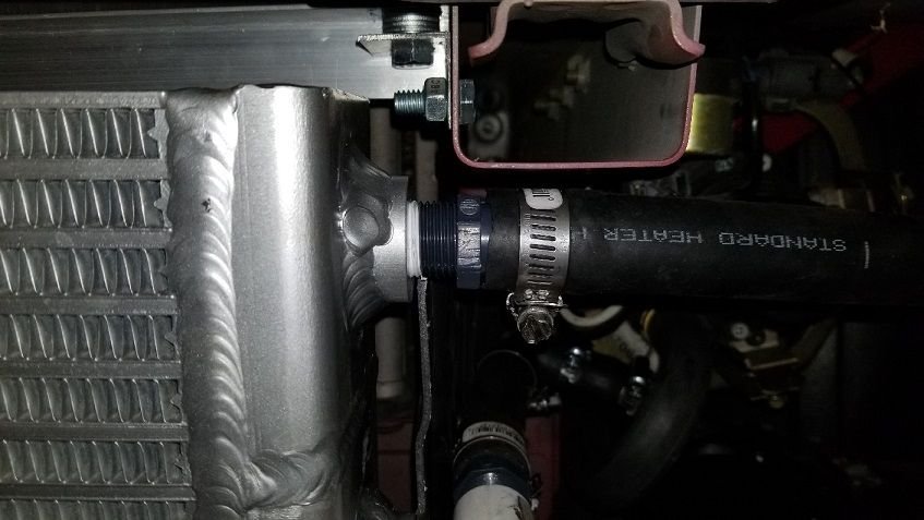

I just got the frozenboost/siliconeintakes 3.5" heat exchanger installed and wanted to share with you guys how I mounted it. This is similar to the way AP1chief mounted his. It took me all day but it's well worth it. This is my first time fabricating something for fitment. The bumper required a bit of trimming but not much. I just got done installing the fx300 clutch and waiting for my Novi 1220 upgrade to come back from Paxton.

2x 90 degree elbows. Hopefully the plastic fittings don't fail. I couldn't find brass fittings locally at the time of install.

PVC will over time while exposed to heat become very brittle. That is a ticking time bomb. Replace it with Brass before it breaks.
x2

I will keep that in mind thanks! Probably will leave it in for now because it's not a critical component but I'll change them out sometime.
