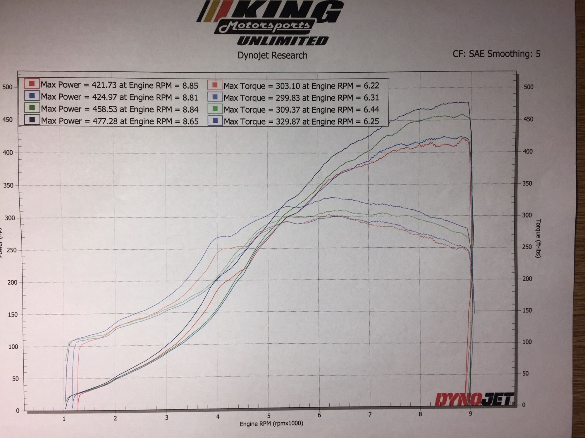

Extremely happy with mine. 421&477 are ~15psi. 93/E85. Top mount recirculated dump
other two is a borg s256 at same psi on 93/100. Top mount open dump.

[QUOTE=s2kfinesse;24785134]Extremely happy with mine. 421&477 are ~15psi. 93/E85. Top mount recirculated dump
[/QUOTE
What's your opinion between the two. Is the much higher of the cost of the g series worth it? how was the transient response vs the borg?

[QUOTE=Charper732;24785151]
[/QUOTE
It looks like the G25-660 spooled up about 500-600rpm sooner. Looking at wheel diameters, G25 has 67m OD compressor and 54mm OD turbine. The S256 has 76mm OD compressor and 70mm OD turbine, so MUCH bigger on the heavy end turbine. I imagine the on/off response of the G25 is a magnitude better than the S256.
