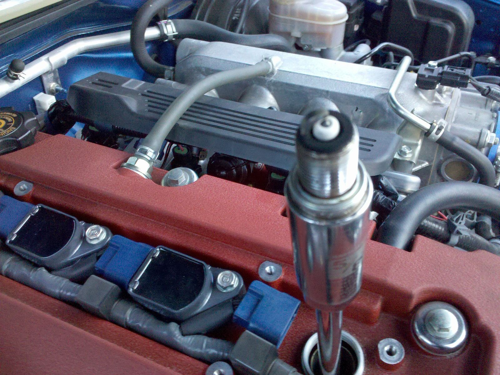

Thanks guys I just ordered an exhaust, a/f sensor w/ harness ,boost sensor w/ harness for the emanage. I all ready had the colder plug in and here is cylinder 1.

looks pretty rich...did you pull the plugs immediately after doing a pull?

since i took this picture I've put in a wide band and full exhaust. the car is pig rich and wot, but lean on part throttle. and yes this was after a pull.
