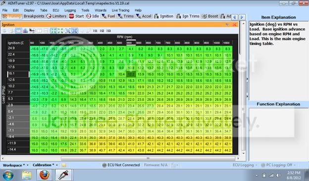

hi guys i need other opinion for the map that my tuner made. can you post your opinion. i need more advice because he has not many tuner choice here and didnt know nothing about the s2000.
here my setup
stock f22c with 3mm inline pro headgasket.
750 rc injector
custom sidewinder manifold with gt35
3 inch exhaust
skunk 2 70mm throttle body
walbro 255 lph
91 octane fuel
if you have any question feel free.
click on my link to download the map.
thanks for your help and your time

I think you have way too much timing, I a running about 5 degrees less from 5k to red line compared to your map, that is if you are also boosting around 9 PSI, I have a similar setup but with a precision 6262 and 1000cc ID, and with OEM head gasket, I don't know if by adding the head gasket you could add that much more timing, but even then i think its too much timing
I am also running Meth, and during my tuning sessions, i lost power when i added more timing
How much boost are you running?

sorry guy do you have a method to put my map on this site. i boost 14 psi and no meth

Do you mean something like this....
This is yours by the way

Timing of 16 at 14psi is awfully high for 91 octane. I would do a WOT pull and check your knock volts for spikes.
