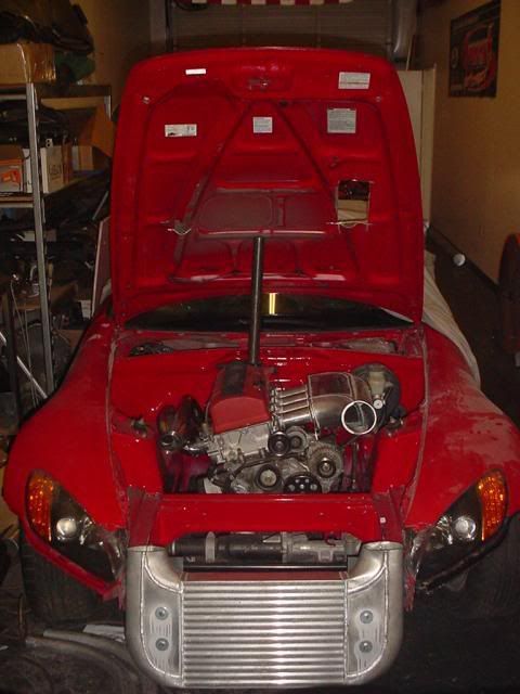

was surfing the web and i saw this intercooler.. kinda differant stlye.. what do you guys think? looks bored out to me....

that guy is a member of s2ki... I think his name on here is jg-fab.com or something like that... i'm not sure about ported but I think he fabbed that intercooler from scratch... same with the intake manifold... LOOK AT THE OPENING ON THAT THING!!!

The whole aftercooler unit appears to be a possible limiting factor when running high boost. I'm not sure how much cfm/psi Vortech based the size of this aftercooler on. I think a front mount intercooler would work best for your boost level Phil.

that thing is ridiculously huge

isnt that guy shooting for 800+whp?
looks like he bored out his bonnet as well

Do you guys think that this stlye Intercooler would work better than a regular one?
